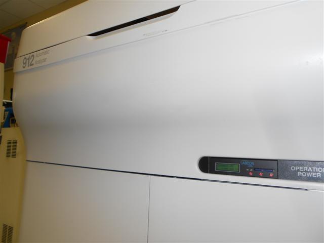

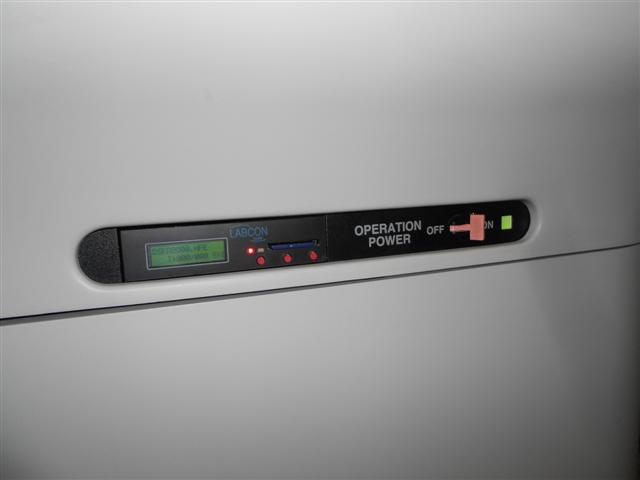

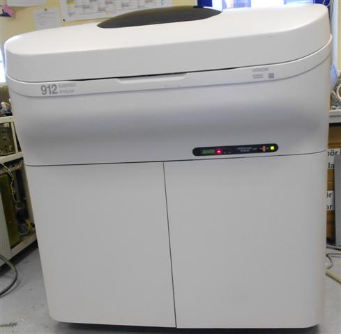

Re: HxC on a chemistry analyser
HXC Floppy Emulator in Hitachi 912!
- DSCN8762 (Klein).jpg (77.44 KiB) Viewed 57337 times
- DSCN8758 (Klein).jpg (75.71 KiB) Viewed 57337 times
- DSCN8755zug (Klein).jpg (77.31 KiB) Viewed 57337 times
HXC Floppy Emulator on Hitachi Analyzers Hitachi 911 Hitachi 912 Hitachi 917 Hitachi 902 Elecsys 2010 Dont hesitate to contact me! service[at]labcon.de
