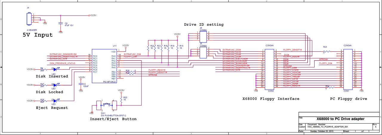

First schematic version of the PC Drive / Floppy Emulator adapter for the X68000 :

Jeff wrote:First schematic version of the PC Drive / Floppy Emulator adapter for the X68000 :
Good job, my dear engineer.
So, this adapter is going to work both with a real PC FDD and HxC emulator?
Have you done only software simulation or tested the circuit on real hardware?
Is the PIC code available?I'd want to try the circuit and report feedback.
Re: HxC SD floppy emulator works with X68000 CompactXVI
caius wrote:So, this adapter is going to work both with a real PC FDD and HxC emulator?
Yes that's the idea.
caius wrote: Have you done only software simulation or tested the circuit on real hardware?
I am writing the software, so schematic change still possible ;)

OK.I see you emulated all the extra X68000 signal and not only the most important (INT and DISK IN).Like other solutions also the yours will requires to activate a switch to notify the insertion/eject of a disk/disk image.
OK, Jeff, I wish you a good work and keep us updated.I'm always here if you need deep testing.
