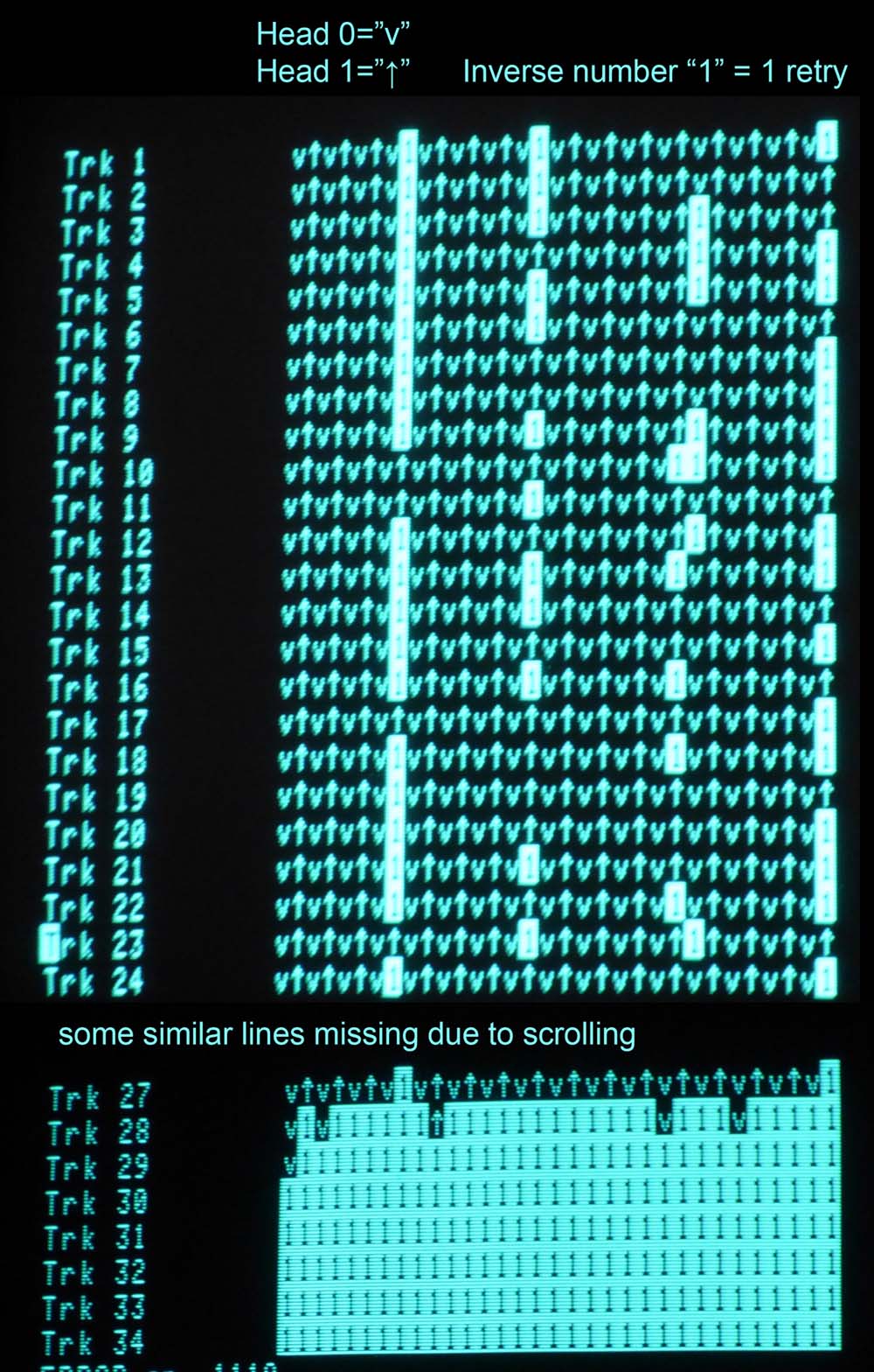

Additional information:
the attached image shows in graphical form, when the errors occur.
There seems to be some loose pattern and beyond a certain distance (track 28 ff.) errors occur each time sector 0 is to be read.
I also played a bit with additional 1K terminator resistors but could not produce any change.

The mechanical mechanism is basically the Tandon TM-100-2 drive, this was supported by research of archival HP documents.
HP Flexible Disk Formats
Martin Hepperle, June 2016
http://www.bitsavers.org/pdf/hp/disc/91 ... ormats.pdf
The 13272 is different from the standard TM-100-2 (found with IBM PCs and other computers) in its control board.
Part of those differences are due to the 6 additional circuits with the 40-position card edge connector.
While I have not had time to “reverse-engineer” the board, some of the differences are the multiple conductors to handle the current (Amps) for the small gauge wire. The 13272 handles drive numbering different than the standard Tandon TM-100-2 control board (with their standard 34-floppy card edge connector).
