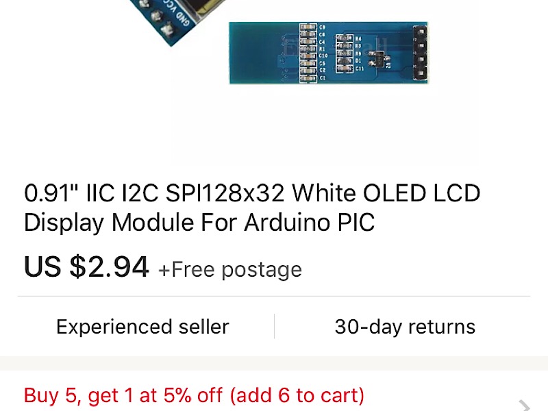

Btw where did you get this screen exactly ?

This is the one I’m using

dougal wrote: Wed Nov 29, 2017 10:50 am This is the one I’m using
Could you put the exact same link you used to buy it ? Your picture previous picture and this one don't match.

https://www.ebay.co.uk/itm/0-91-IIC-I2C ... 2749.l2649
This one - Its from my eBay account

I know from the pic it looks exactly like the one you told me to get (which I bought since you told me) but that link is of the one I currently have now. Its the actual eBay item I had bought in October.
Re: Problem with OLED and Gotek
dougal wrote: Wed Nov 29, 2017 11:35 pm I know from the pic it looks exactly like the one you told me to get (which I bought since you told me) but that link is of the one I currently have now. Its the actual eBay item I had bought in October.
i see "www.diymore.cc" printed on yours screen + it have a different parts annotations. This sound odd.
