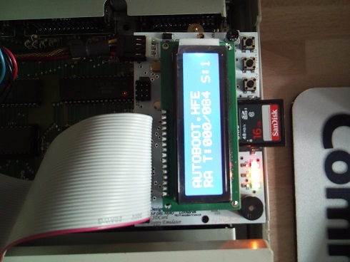

Hi we are Jeff,
Is the LCD screen supposed to say AUTOBOOT.HFE at boot up?
Regards
Marc

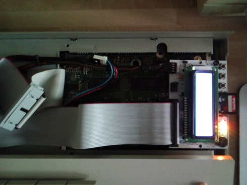

Floppy extension plugged in the opposite way, red marker to the left,
tried plugging in extension both ways at either ends, still getting the same issue.
Is the floppy LED access light supposed to be on all the time?
Regards
Marc
Re: Atari ST 1040FM HXC Not Working?
MarkyB wrote: Wed Mar 14, 2018 10:52 am Floppy extension plugged in the opposite way, red marker to the left,
Regards
Marc
the situation is the same : "RA" and "S:1" and the select led permanently on.
You need to invert only one end of the floppy ribbon.

It is only inverted on one end of the floppy extension?
Might be worth attaching the Rev C to the computers original ribbon, exclude the floppy extension, work back, sure that will show if theres a fault with the Rev C board?
Regards
Marc
MarkyB wrote: Thu Mar 15, 2018 12:15 pm It is only inverted on one end of the floppy extension?
Regards
Marc
yes this can be a good test to do.
