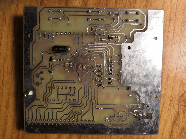

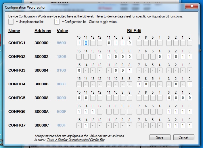

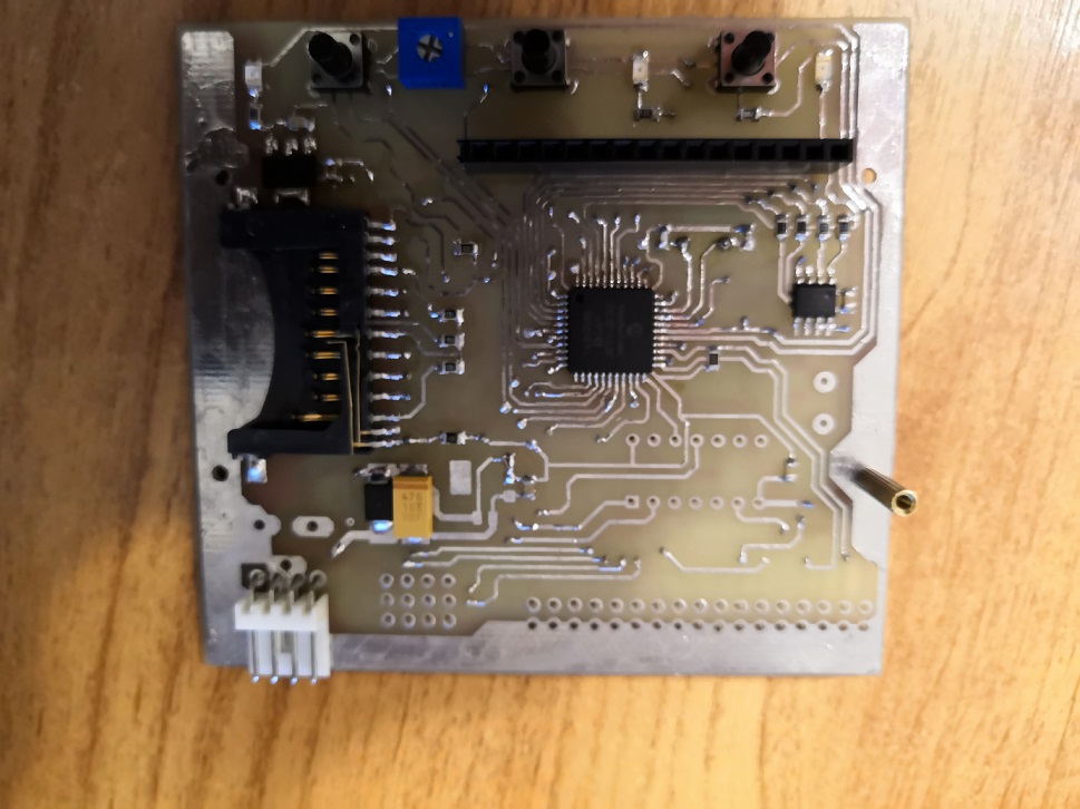

Hello!
0. The server is not defined as a device.
1.PIC18F4620 flashed.
2. The LED does not blink.
3. On quartz 10 MHz.
4. If you turn off the quartz, the blinking of the LED appears at a frequency of 15 Hz.
What can be wrong?
1 orriginal fuse.jpg (125.28 KiB) Viewed 8773 times
Re: HELP! SecSerialBridge software - ends with an error.
ncbelov wrote: Thu Feb 06, 2020 1:02 am Hello!
What can be wrong?
Is the quartz oscillating properly ?

Yes.10.0005mhz
ncbelov wrote: Thu Feb 06, 2020 1:46 pmYes.10.0005mhz
Then check the SRAM connection/communication. An auto-test should be done at power up.

If the SRAM is not working, can there be problems with the LED blinking?
ncbelov wrote: Thu Feb 06, 2020 5:25 pm If the SRAM is not working, can there be problems with the LED blinking?
blinking may be normal. Can you show me how it is blinking ?
