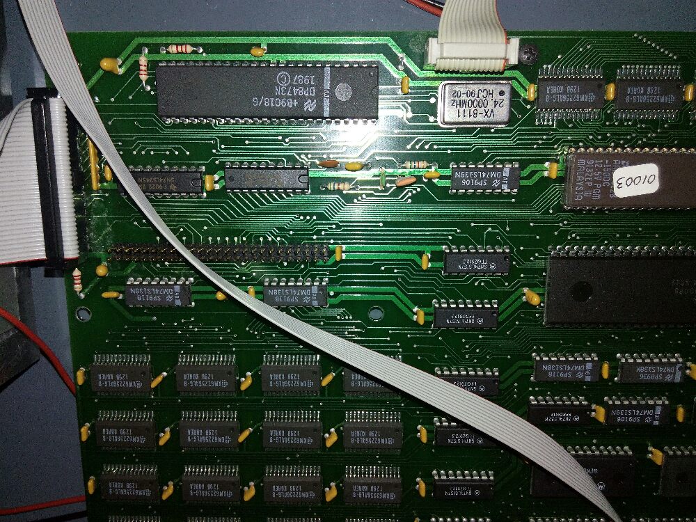

No, service manuals or schematics are unobtainium, unfortunately. This device is really rare, and there is only very little information on it on the web. It was distributed by Zadok, a dutch company, and it went under the name of "Double Dutch SAM-1".
This is how it looks inside, maybe the chips around the floppy port give some hints?
