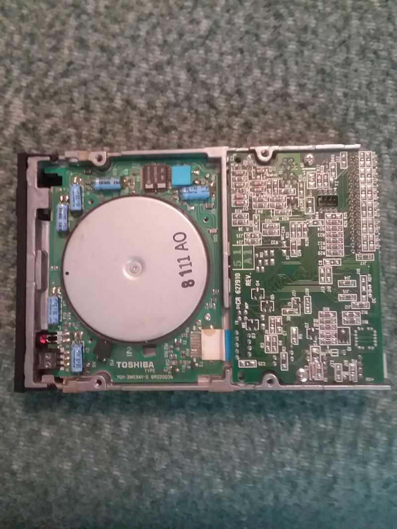

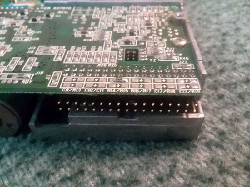

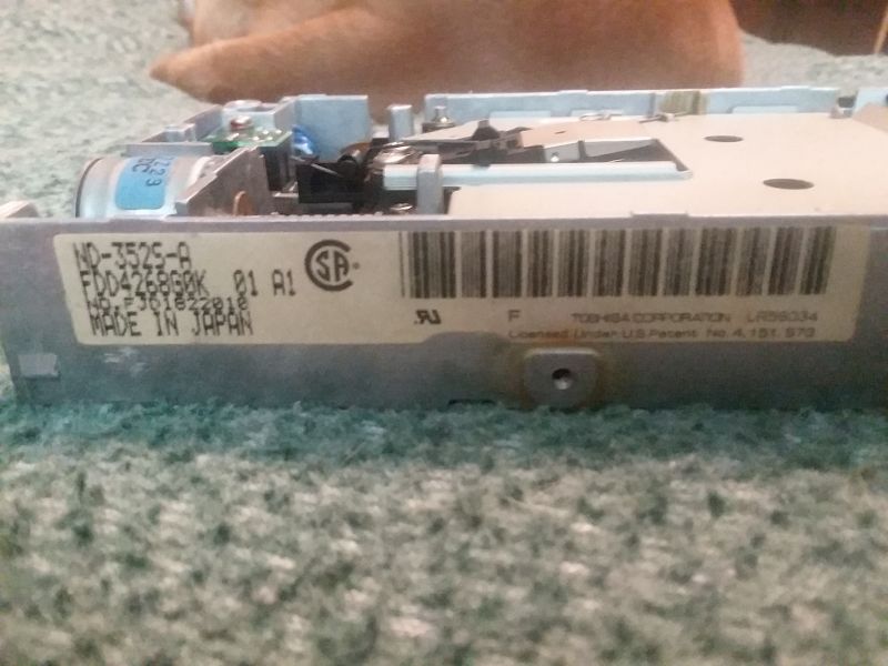

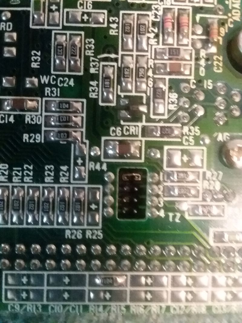

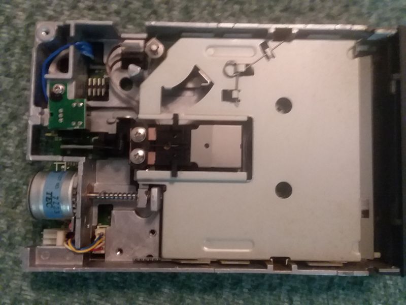

Do you still have the original drive and a voltmeter ? Can you check the pin 2 state with and without disk inserted ?
Can you also make some pictures of this drive and post them here ? (want to see the model number, the jumper block, the connector, the pcb...)

Pin 2 shows zero voltage until an operation is performed such as checking disk status then it jumps to 5V and will remain there until you remove the floppy disk... here are some photos
PaulStahl
Posts: 33
Joined: Sun Mar 03, 2019 11:16 pm
Re: Yamaha QX3 and the Gotek USB
Post by PaulStahl »
rest of floppy drive pics...
Ok thanks !
Try the attached firmware and config file.
Clear the internal settings after the firmware update (press the right button at power up).
test1.zip
(81.85 KiB) Downloaded 988 times
