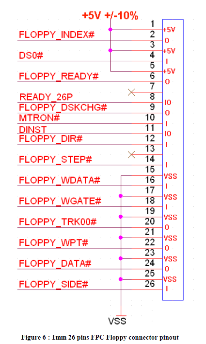

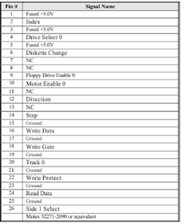

Nevermind Jeff, I think I´ve found my problem... Some pins are exchanged (pin 6 and pin 9 are swapped) and others are non connected how you can see in attached images. Do you have any clue about how to fix it or exchange connectors? I think it is the only way to resolve this problem. Thank you in advance Jeff.
Best regards.
Re: Yokogawa DL750 Oscilloscope with SDHxCFESlim
Have you tried to connect the pin 9 to vss/gnd ?
