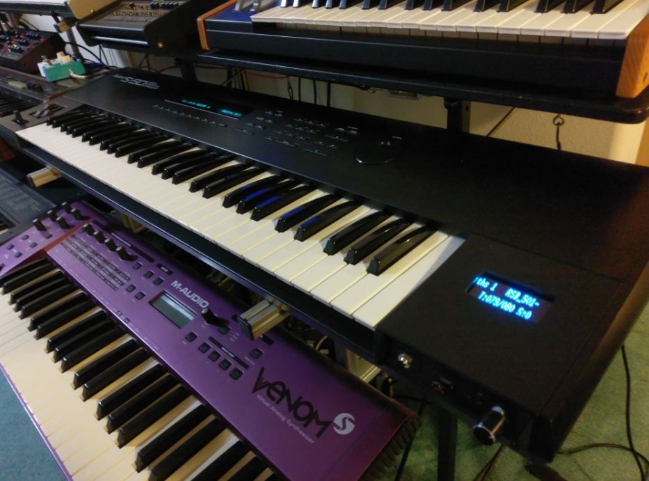

How exactly where you able to make the S-50 load faster?
What is your load time now?
I'm using a Gotek flashed with HXC and would like to figure out how to make it load faster.
Dana
Custom S-50.JPG (94.7 KiB) Viewed 45558 times

dfiorucci wrote: Tue Jul 27, 2021 6:35 am I'm using a Gotek flashed with HXC and would like to figure out how to make it load faster.
Is it currently loading with a floppy drive speed ? If so all is fine, don't bother to try to make it faster, you will only gain some little seconds.
