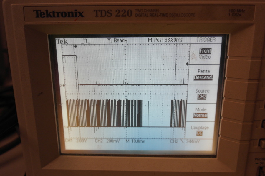

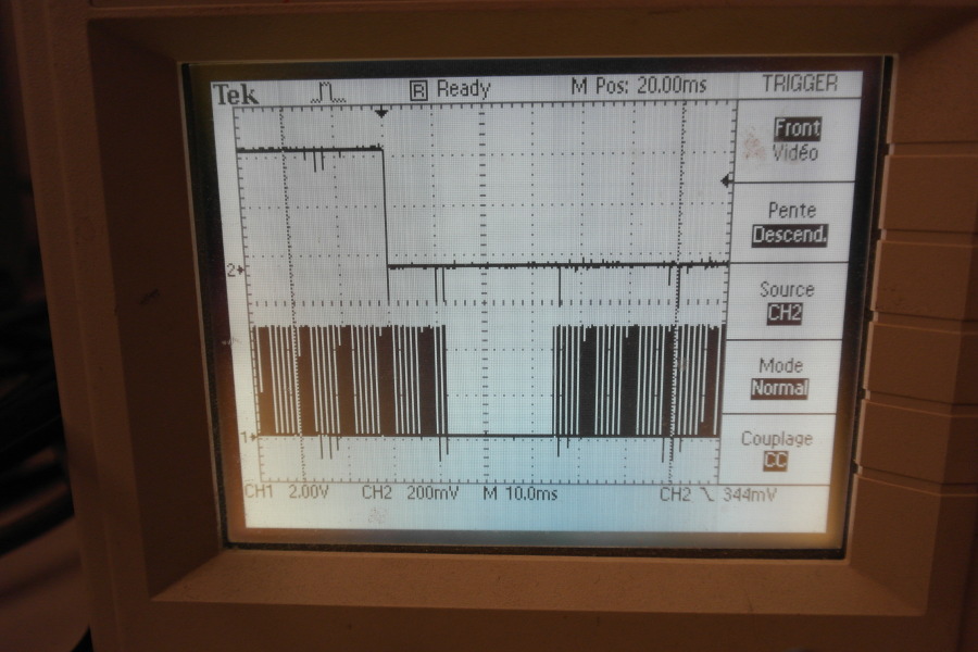

AMSynths wrote: Thu Aug 29, 2019 6:36 pm Hi, yes with the latest files.
Just tried the 2 images : I see the blank part as expected. If you use these files you should have the same blank.
