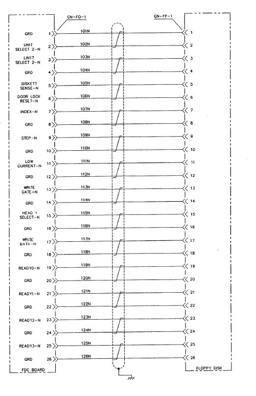

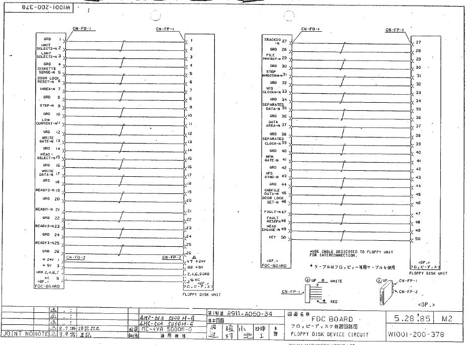

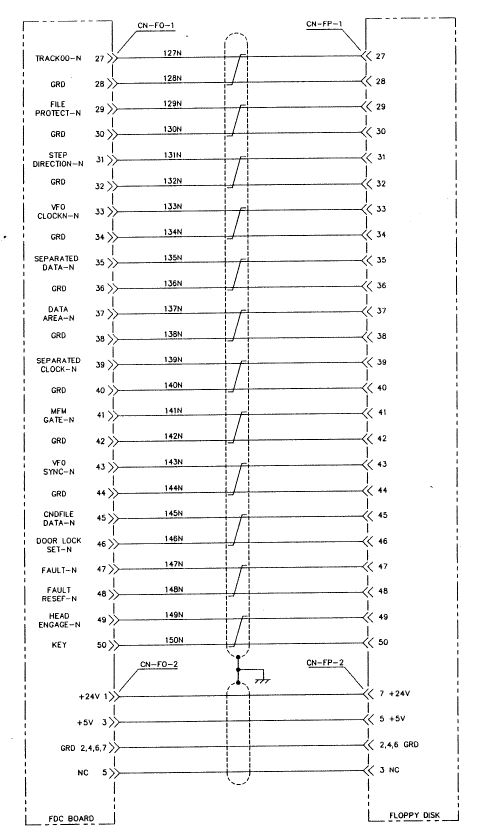

By the way- in attachements there is FDD pinouts and connections to OSP5000 FDC board that I got from manuals I have for my machine. Hope it can somehow help. One of the possible solutions would be to make a dump from original 8'' floppies and write it to a 3.5'' floppy (OKUMA OSP5000 and OSP5020 systems have an option of FRP board that is used together with 3.5'' drives). Older OKUMAs are beasts- mechanically everything is in perfect state, CNC system also works, only headache is created because of these oldschool 8'' floppies.

Thanks, this is certainly helpful, for me and other readers!CNC_USER wrote: Sun Apr 18, 2021 1:41 am By the way- in attachements there is FDD pinouts and connections to OSP5000 FDC board that I got from manuals I have for my machine. Hope it can somehow help.

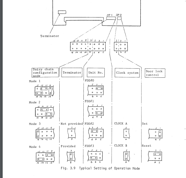

Re: Hitachi FDD-412A 8 inch floppy drive
The Sharp fdd412 floppy drive has an identical jumper configuration in its number of pins, and in the floppy drive that I have in my hands the configuration matches the standard.
- posibles jumpers.png (65.99 KiB) Viewed 43857 times

Want to jump again in discussion- did You guys have any results with the drive? Im trying to get data from installation disks (OKUMA OSP5000M-G), but I cannot figure out- where exactly is DATA READ pin/output. From the pictures here an output shoud be on pin 37 (Data area). But I managed to get something out from disks(that looks like flux stream, but Kryoflux doesnt understand it and thinks that it's unknown data) only on pins 35 (Separated data) and 39 (Separated clock).But if we take a look on circuit fragment which is also here, they are inputs!!! And that circuit is not from this floppy drive- its from device side, not the floppy drive.
And how to understand that note in pinout about pin 37: Used as FILE DATA-N by selecting short plug? Please help- this drive is driving me crazy.

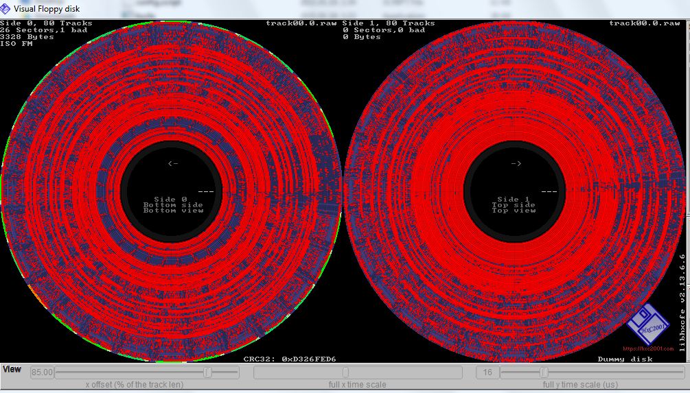

Try to make a preservation stream with the kryoflux and use the hxc software to open the raw files.

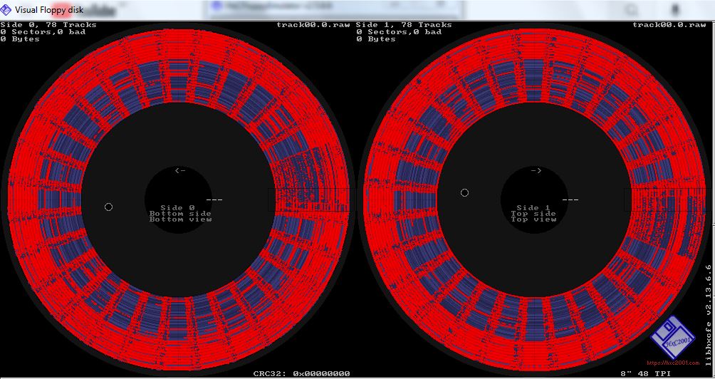

Situationwith these OKUMA system disks isn't that easy. Only the first track is encoded as FM, all other information is some rather obscure method of encoding. This is how it looks (two separate disks from two different machines, one machining centre with 10 files on it, second from lathe- 18 files on it). Kryoflux understands and decode only first track on both. Both disks arent damaged nor held near any magnetic fields, machines read these perfectly. Problem is in getting out one 256 byte file with machine parameters.
