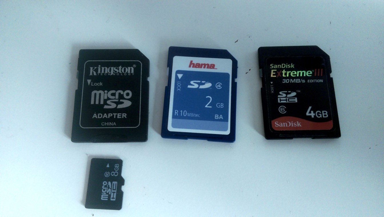

Re: Acorn A3000
Here's my SD cards I've tried.
- sdcards.jpg (129.01 KiB) Viewed 33759 times

Re: Acorn A3000
Jeff,
When I try update the firmware the LCD shows 1 line of black blocks like all the pixels are on. The lights flash furiously but nothing completes..
My current firmware is: v1.8.2.40
Ok wait.. Ignored the blocks.. There is a lot of flashing like its copying and then it goes into a 2-flash, 2 second delay cycle. So according to your docs thats SDcard init failure.. ? Gonna try a clean SD
