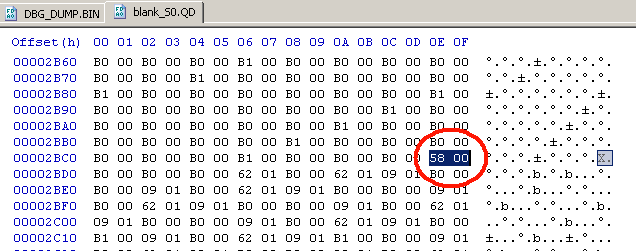

OK - here is a saved stream
EDIT : blank_S0.QD.zip removed.

In 10 seconds i have spotted the special value right before the sync word !!! :D
I will check all the sync word values but i think we have found the cause of the issue ! (same for the Roland machines i think...)
Re: 2.8" QD Disk Emulation
Confirmed ! This controller do an "insane" thing to trigger the sync word detection.
9.7us, 14,7us, 19,6us are normal values. 4.9us is not normal at all in mfm regarding the bitrate.
The issue with the firmware is that it change this 4.8us duration to 9.7us. Then when the machine read back the track, it doesn't see the 4.8us glitch and doesn't see the sync word right after.
The good news is that this is very easy to fix. A new firmware to try in some minutes.
