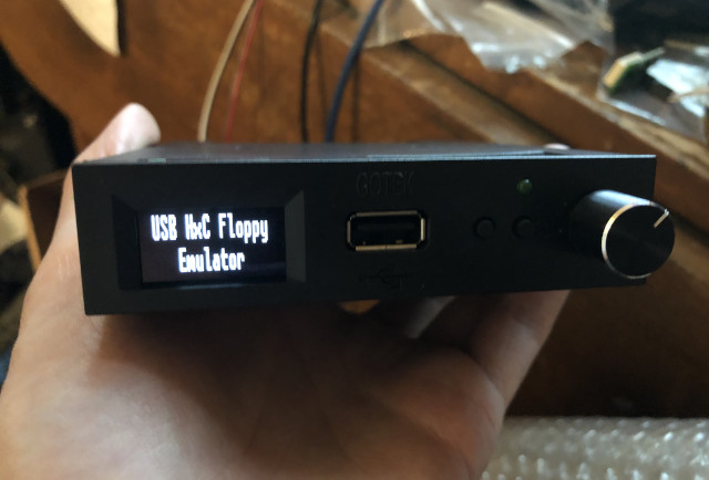

- New SFRKC30 Gotek boards support added :
This new Gotek revision has a new rotary port and will be shipped
with a rotary switch and an OLED screen directly from the factory
(No "mod" required anymore)

-> SFRKC30 / SFR1M44-U100LQD Gotek support enhanced :
- The new rotary port is now supported.
- New explicit U100LQD OLED configuration. (https://hxc2001.com/custom_fw/)
(Specific binaries for this new Gotek are now provided in the "New_U100LQD_Gotek" folder)
-> The detected hardware model can now be read in the embedded menu
(Sub menu 'F' for the 7 digits Gotek and in the "FW/HW version" sub menu
for the OLED Goteks).
