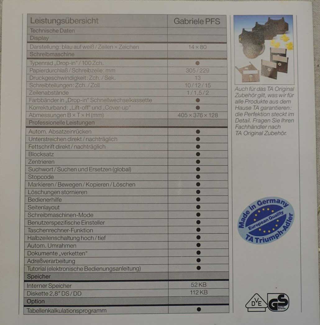

I have an Olivetti TOP 100 typewriter (Also known as Triumph-Adler Gabriele PFS). This unit has a Mitsumi Floppy Drive with 12 pin connector. I verified the 12 pin Roland pinout and it is same. I flashed quick disk firmware and prepared the 12 pin connector. When I try to read a blank image, the typewriter complains the disk is either bad or unformatted. When I try to format it tried a while and saying saying bad or unformatted disk again. The unit is almost working, the access LED on the Gotek works. Maybe the writing is failing or the image file needs to change? How can I diagnose this? Just like the above poster, I see RD on the OLED screen, but when formatting it quickly switches between RD and WD. I am attaching the blank and Roland images before and after format operation, there are differences, so the unit is doing something?
Yes i can see the sectors on both images, so this "almost" work. The write appears to be incomplete. You probably need a QD image with a longer track, i will provide you something to test.

I finally found 2 issues :
- The QD track lenght is probably too short. The attached QD file should fix this point. Please format it and share it.
- The sector write is a little bit shifted on the track. This is only some bytes, but this is enough to corrupt the sector : I will have to provide you a firmware fix for this.
Interesting point about this machine : The sectors use the very standard MFM DD sector format (the same used on normal floppy disks!). All sectors are 1024 Bytes long. (i wait your new formatted image to tell you the exact sector count).
