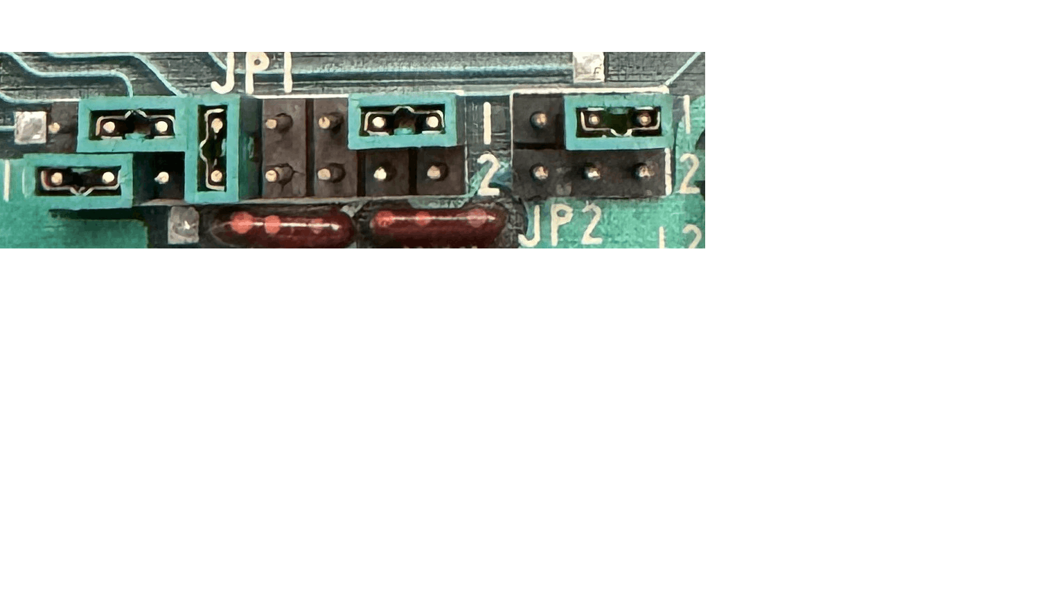

It's August 2026 and I've come into a FDD-412A by way of a disk duplicator on a Japanese auction site.
I'm trying to verify that the drive is operational and found this thread. I see that @someoneontheinternet mentions he found the "service manual" at The Internet Archive, but I've been unable to find this. If you have a copy or know how to find it please let me know.
My drive came without terminating resistor, but I've found a replacement.
I've attached pic of my jumper setting. According to what I've read this means VFO source is disk, VFO output enabled when drive is selected, and decoded VFO to pin 33. Mine does not have jumpers between J1:7&8 while others like @valcanaria have that jumper. Wondering whether that might be termination related.
fdd412a_jumpers (1).png (137.59 KiB) Viewed 1819 times

You can find the manual easily: its the SHARP FDD 412A
https://www.manualslib.com/manual/32924 ... -412a.html

Thank you so much Valcanalia. That's super helpful, and confirms J1:7&8 for termination. I was searching for Hitachi so maybe that's why I couldn't find it. If I get to making a 34pin adapter I'll share my board. The unit I got also came with a YD-380 model 1713 which is a 5.25" 1.2Mb drive with 50 pin connector just like the FDD-412A and also with a VFO. I've been working through issues on that drive like non-functioning index pulse.
