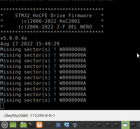

Re: Some of my HxC Goteks are not writting ADFs
Some "good" news : i managed to setup an KS 3.2 + WB 3.2 test machine (A500 + pistorm). And i manage to reproduce the issue ! :
Some notes :
- All is working fine with the FW v5.0.0.4 and the new AT32F435 Gotek.
- With the FW v5.0.0.4 and the QFN32 AT32F415 this is a different story : The track change interruption seems too slow when running with the pistorm accelerator : some steps are missed. And i can see the exact missing sector when writing.

First issue fixed : The interrupts priorities was not set correctly... :?
Second issue : Work in progress :wink: :
Screenshot at 2022-08-17 17-14-29.png (42.75 KiB) Viewed 70709 times

And finally here is the fix :) :
HxCFEUSB_V5_0_0_6a.UPD
(88.5 KiB) Downloaded 4479 times
The problem with the KS/WB 3.2 was that there is almost no gap at the end of the track. The very last bytes are part of the last sector.
(Note : This fix is only for Amiga users with AT32F415 Goteks.
Please use the normal firmware if you have an STM32 or AT32F435 Gotek and/or if you are not an Amiga user).

Seems to work now... I successfully formatted an ADF image from the Amiga, and successfully copied a disk full of files to that image without corruption. I'm having trouble accepting it, but I think you've finally got it licked ;)
For anyone finding this later, it's an AT32F415 based gotek in an A2000 w/wb3.2 and tf536.
