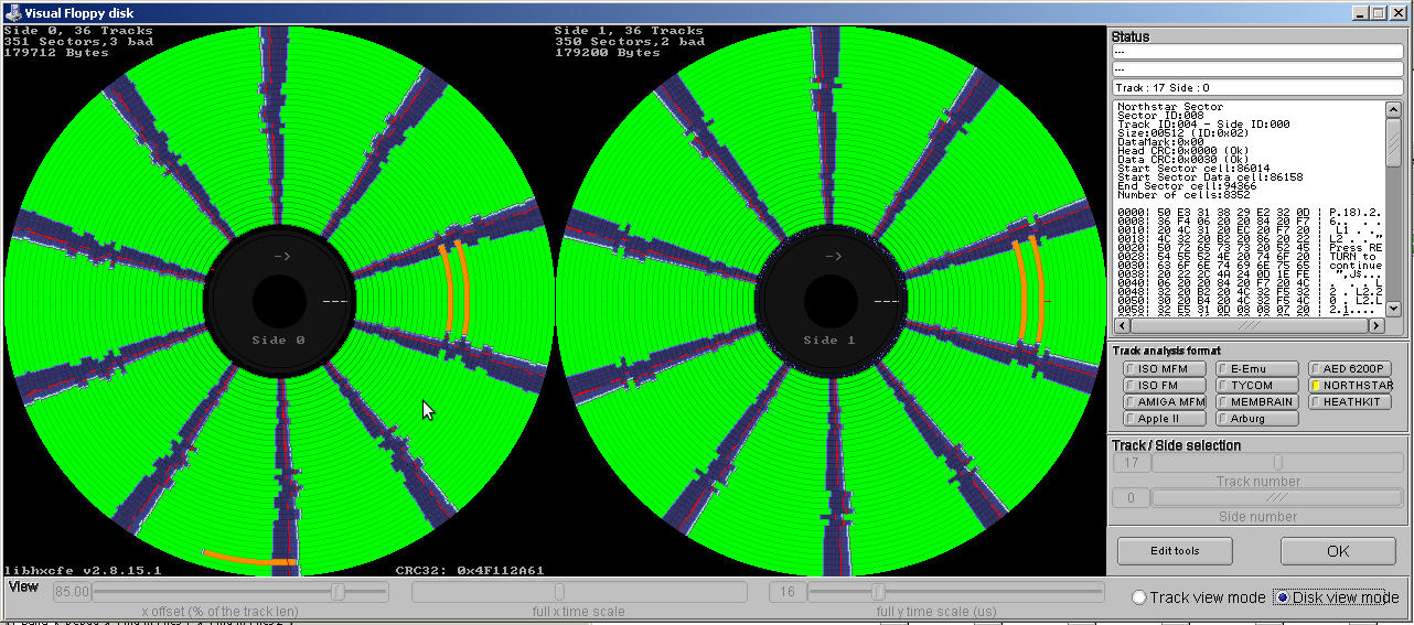

Re: Hard sector format
Some progresses : Now decoding the sectors (with checksum checking!):
:D
snhirsch
Posts: 170
Joined: Tue Dec 08, 2015 1:42 am
Post by snhirsch »
Great work, Jeff! Any ideas about why emulation is failing to work?
And, does a 'red' sector mean failing checksum? If so, there may be still an issue somewhere. The original diskette has no read errors.

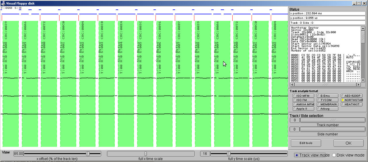

snhirsch wrote: Sun May 20, 2018 2:53 pm Great work, Jeff! Any ideas about why emulation is failing to work?
yes :
index jitter + shifted in the dump.
You can even see this in the screen capture above. the write splices (red lines) should be aligned to the index signal, but as you can see they are not.
Now we have you to find the root cause : the hxc software ?, the kryoflux, the drive you have used to dump the disk ? all the three in the same time :?: :lol:
https://hxc2001.com/floppy/forum/viewtopi ... =60#p18096
snhirsch wrote: Sun May 20, 2018 2:53 pm And, does a 'red' sector mean failing checksum? If so, there may be still an issue somewhere. The original diskette has no read errors.
This is some unused sectors.
