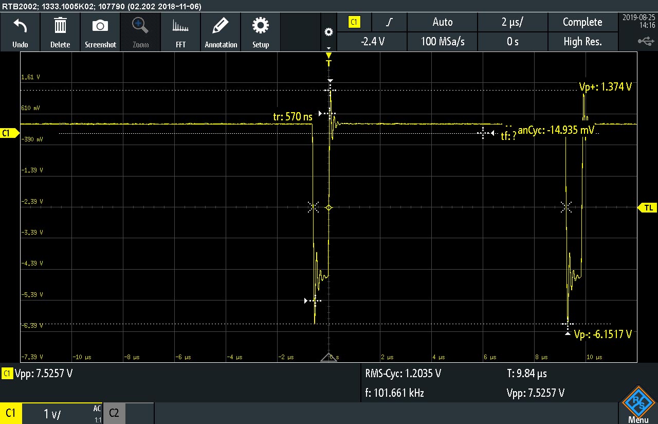

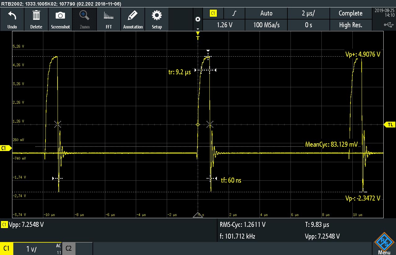

I am using the latest software. Here is the data being read and written. Note that the write is inverted compared with the read, which is in line with the Roland timing diagram. Clock frequency is close to the 101.56kHz from the QD chip on the main board. The pulses are accurate in duration at 9.84us.
The read cycle continues past the display of the Illegal QD message, until the end of the data stream.

AMSynths wrote: Sun Aug 25, 2019 3:32 pm I am using the latest software. Here is the data being read and written. Note that the write is inverted compared with the read, which is in line with the Roland timing diagram. Clock frequency is close to the 101.56kHz from the QD chip on the main board.
Why the write pulse are in the negative voltage value ? Are you in AC mode ? There is also lost of ringing. is the oscilloscope probe ground connected ?
