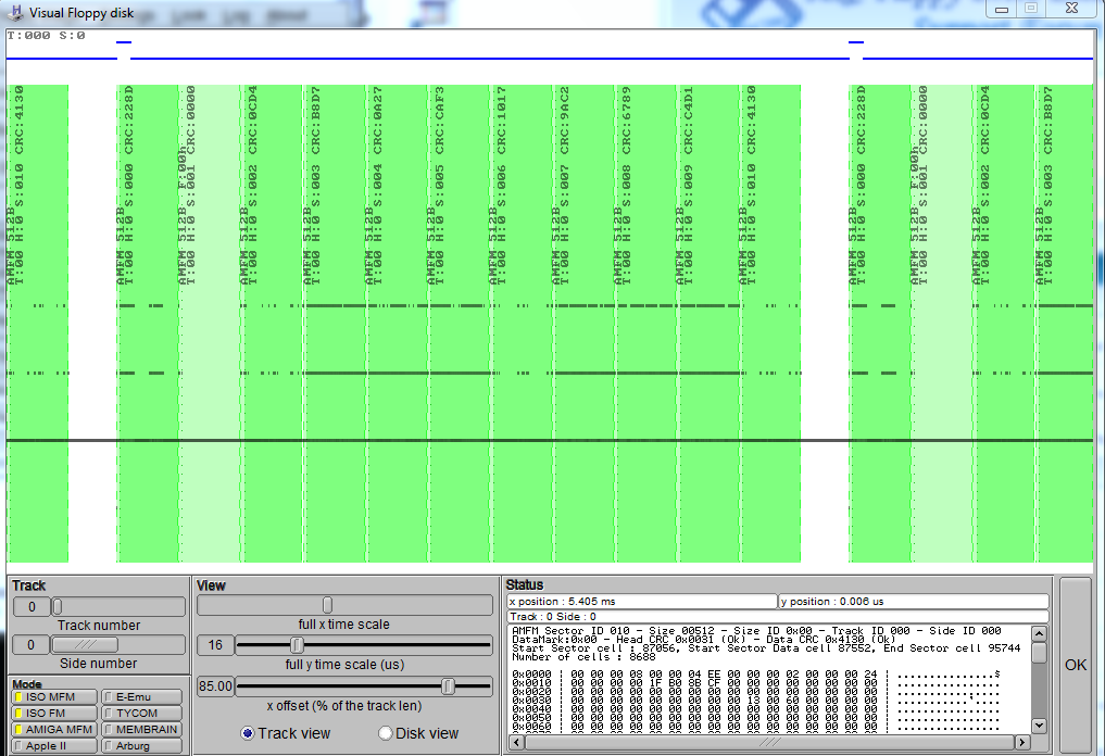

Use the hxc software and the track viewer to check your disk image.

Ok, I did that, not sure exactly what I'm looking for. All of the sectors of each track are bright green (i'm assuming t == track s == sector), but track 0 has a few sections that are sea green.
I've attached an image

I found another image of the same version of Workbench and that is working better. But I'm having difficulty switching disks when prompted. The LCD buttons are just cycling between the disk in A and autoboot.hxe. It's not allowing me to traverse the SD. Is the use of the autoboot.hxe mutually exclusive with use of the LCD/buttons?
