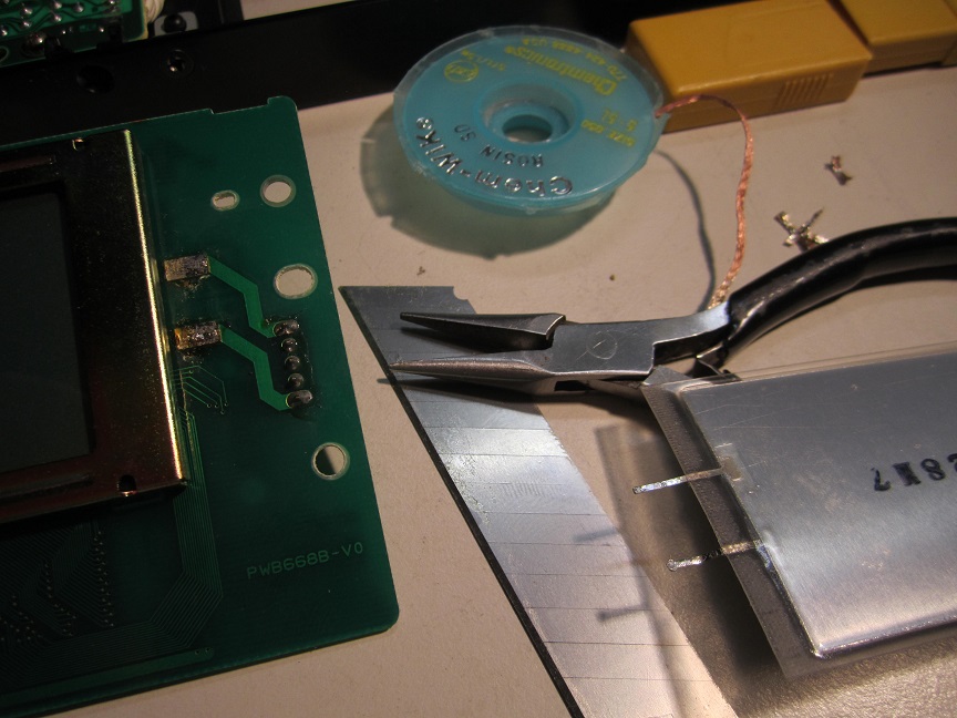

Replaced the backlight panel for the FZ10m yesterday.
The old one was real dim already and getting dimmer in time, barely visible in the dark and also caused problems. After a couple of hours in use the port cable transmission failed and no sound was coming out anymore.
First I thought it was due to lifting ground. See previous postings about this subject. Jeff warned me for this.
Port transmission faillure happenend before, but next day everything worked again as usual. This should have rung a bell.
When there was no sound anymore I knew it had to be the backlight panel so a week ago I ordered two panels by Backlight4you for 11 euro's each. A soft-yellow which is now inside (but rather than yellow shows a bright, green glow} and a blue-green as a spare.
I'm convinced now that lifting ground to get rid of the ground loop noise will cause no further problems.

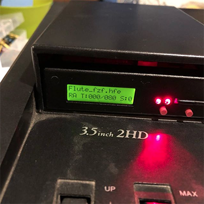

I can't mount .hfe files from the emulator, and when I try to save a voice I've created in the FZ-1, it says "Disk Protected".
Any ideas what I've done wrong?

Which emulator exactly ?morning guts wrote: Fri Jun 08, 2018 3:04 am Hi,

Please select an image and take a picture of the HxC lcd screen and share it here.

Jeff wrote: Fri Jun 08, 2018 1:18 pmPlease select an image and take a picture of the HxC lcd screen and share it here.
- HXC 1.png (245.02 KiB) Viewed 63320 times

Reconnect the floppy ribbon to the other way.
