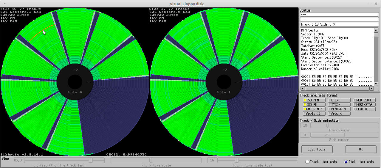

i will post the current disk layout to show you the issue.

Here it is :
One bad sector + something wrong with the rpm or the sector gap.
