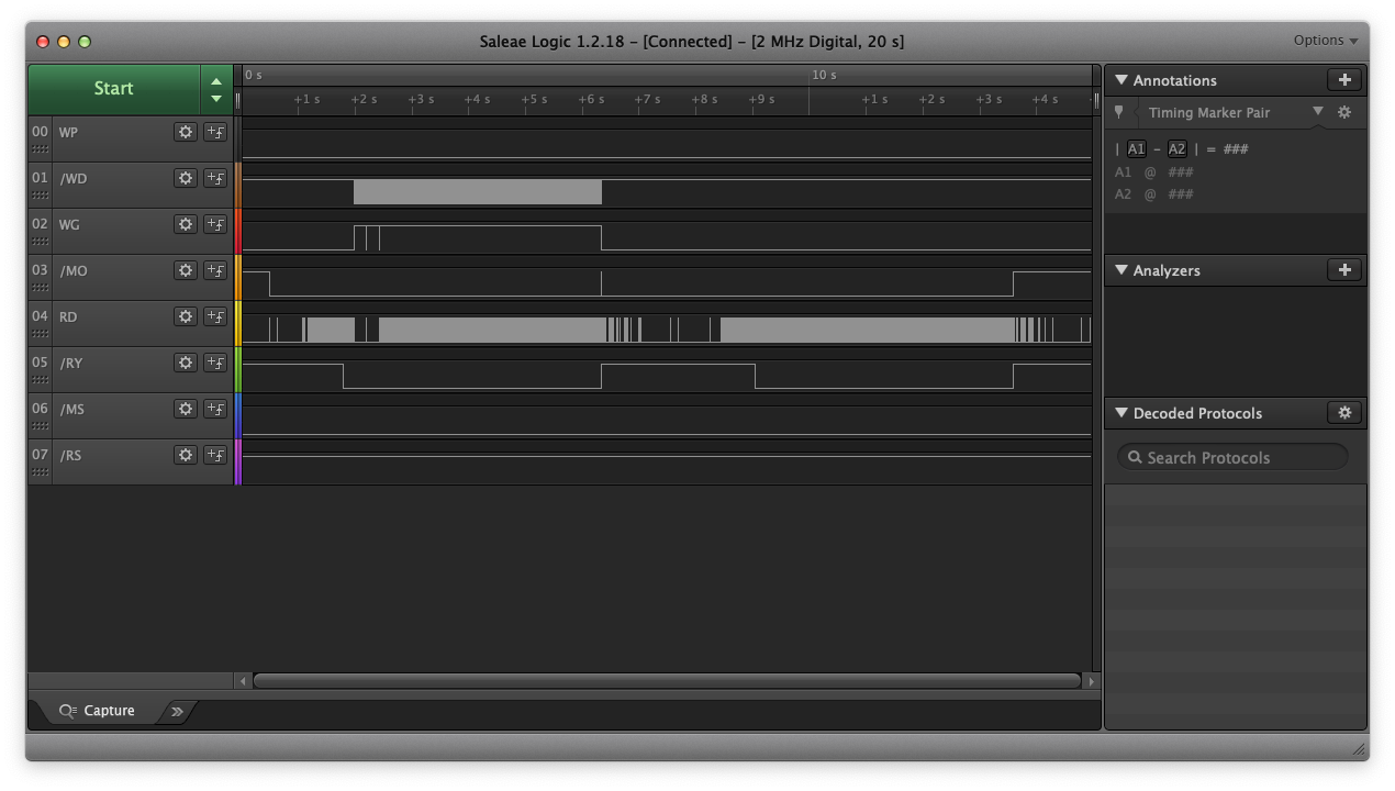

This is a write trace.
It actually did three passes, where the third fell just off the 20s window. Not sure why three, it looks like it's only doing a write in the second pass.
Note, this is an A/B sample, so it will ask you to change the disk between saves. That might have something to do with the additional read cycle. I'll do one that is single-sided.
Let me know if you want to see something specific.

Write cycle after overwrite check (I waited for the drive motor to stop before confirming overwrite), so this is a write and verify cycle.
So you're right on the Reset line. It doesn't seem to do anything at all.

Re: 2.8" QD Disk Emulation
ohh thanks a lot ! So this confirm that you have also this short ready state here :
viewtopic.php?f=2&t=773&start=375#p21408
And we can also see the 3 blocks write . :)
Can you add the others signals on the others channels ? (MO, RD data, WR data...)
Is it on the real QD drive ?
Can you export these data to a file ? i want to check some precise timing.

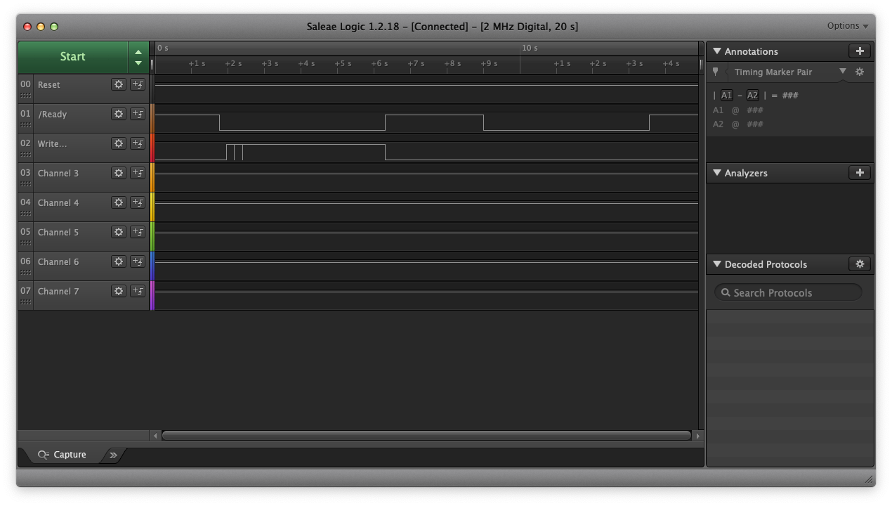

Post by etaoin »
Jeff wrote: Tue Sep 17, 2019 2:23 pm Is it on the real QD drive ?
Yes, this is on the real drive.
I was just wiring it up for the full 8 channels.
etaoin
Posts: 43
Joined: Mon Sep 16, 2019 3:10 pm
Post by etaoin »
Jeff wrote: Tue Sep 17, 2019 2:23 pm Can you export these data to a file ? i want to check some precise timing.
What format do you want?
Schermafbeelding 2019-09-17 om 14.40.39.png (18.06 KiB) Viewed 177187 times

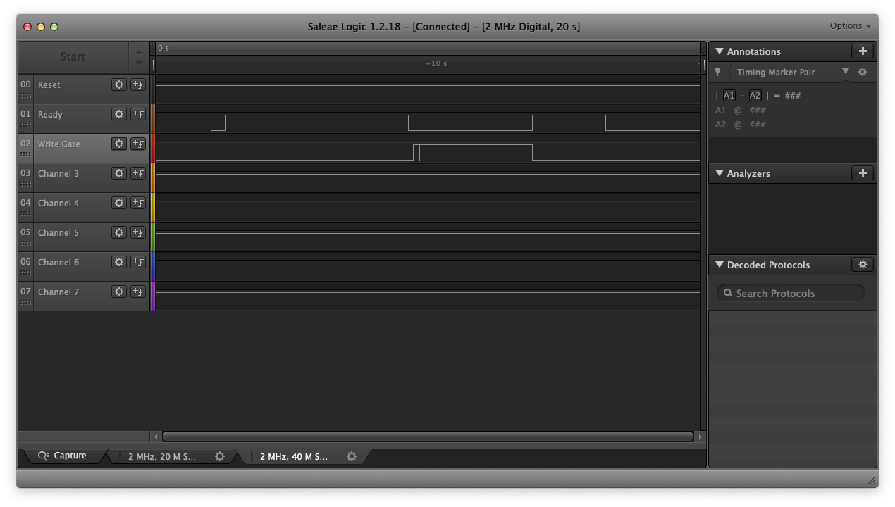

Post by etaoin »
full probe
