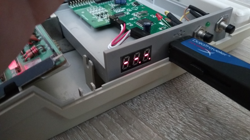

I use HXC for Gotek in my Amiga 500.
Now the Amiga has been in the box for a few years, and after turning it on, Gotek doesn't report, I can't even update the HXC.
I can ask someone for help.
See photo.
Thank you for the advice.

What can you read on the gotek screen without any usb stick connected ?

Nothing, it still behaves the same, from USB or without it.
Still the same condition.
It does not respond even when I am going to program (update via USB), both buttons are pressed.

This doesn't seems to be an HxC Gotek. When do you have programmed it ?

I'm not sure if it's HXC firmware, I bought this goth a long time ago.
I assumed it would be HXC firmware.
Would overflashing the firmware help?
But I don't have flash pins on the gothic, could I use the USB cable method? (USB-A <> USB-A)
Re: Gotek Amiga 500 - does not respond
joys_333 wrote: Thu Feb 11, 2021 12:00 am But I don't have flash pins on the gothic, could I use the USB cable method? (USB-A <> USB-A)
yes USB-A <> USB-A method is supported.
