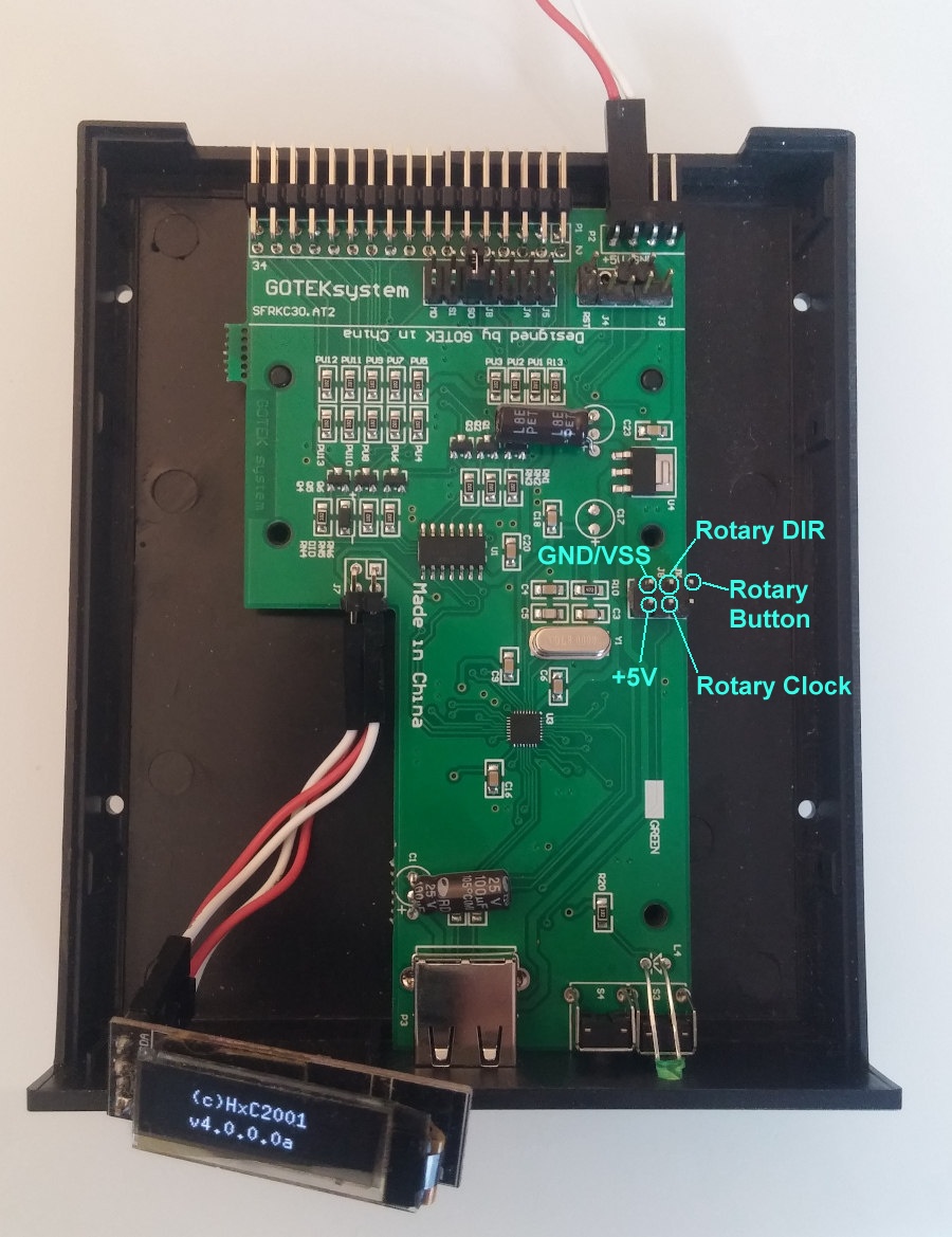

Could you say me if my connections are corrects ?
because when I turn the rotary i can't navigate trough files. I can navigate only with the Gotek native buttons.

Here is the rotary connections to use :

Thanks, it's more clear with your picture.
With you schematic when I rotate to the right the files decrease (5 to 4 to 3 to 2 to 1)
Is it possible to change that order ? from 1 to 2 to 3 to ...

I just needed to invert the CLK and DT .
That's work well
