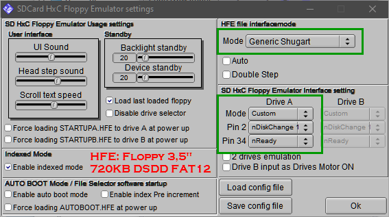

The MDR does not work for me on the EL-70, either no HxC Rev F, nor a fresh burned GOTEK.
Does Jeffs “yes!” mean that the HxC Rev F should work only with the reverse connected cable, without any further modifications? :?:
I always get the error message "inSt" (no disk inserted) when I press some button. The DiskBrowser shows all disks fine. HxC and GOTEK on a PC as floppy even works fine.
Thanks for any help!
kpw
Joined: Tue Feb 11, 2025 11:10 pm
Re: Hxc SDF Floppy Drive Emulator in Yamaha EL-70 organ?
Post by kpw »
Many thanks to Jeff for his superior support, he saved my day!!
For anyone who has the same problem:
HxC Floppy Emulator settings, 3,5'' 720KB DSDD FAT12.png (38.91 KiB) Viewed 108535 times
-> Switch to ID0A / S0 to ON
