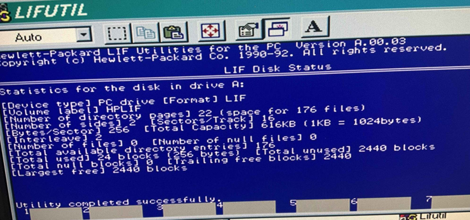

I have a Windows 98 PC that is MSDOS compatible and I have established the correct LIF format that works in the 35660A. I can format a real DS/HD disk (with tape over the HD hole so it looks like a DS/DD) using Lifutils that has a preset for a 616K LIF, 2464 blocks, 256 bytes/sector, 16 sectors/track. This loads fine in the 35660A. Problem is it doesn't have IBASIC on it and Lifutils cannot handle this type of file (File Type 4000 I believe ?). What I have managed to do is format an HFE blank 720k Image from lifutils on the Gotek and using the greaseweazel I can write this to a floppy and it works in the 35660a. This means I am 90% there but I cannot work out how to now use the HxC Software with my Flux images and what I know about the lif format from the blank Lif HFE that works, to create an SCP/HFE with IBASIC on it.

- IMG_1822.jpg (226.95 KiB) Viewed 14424 times
