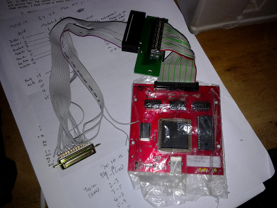

Since I am very long-sighted (i.e. everything close is blurry), building a 26-to-34-pin adaptor was a very difficult task. In the end, I found that it was easier to use a PC motherboard printer port cable, a 25-way D plug and an old floppy drive cable. Does anyone know whether I can purchase one of these 26-to-34-pin floppy adaptors, ready-made, please? This is for future projects.

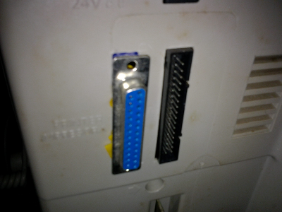

With the PCW's floppy drive cable almost broken, I was only able to use one of the drive plugs. I soldered two 26-way PCB headers back-to-back, plugged a motherboard parallel port cable into this, and then attached this to the back of the PCW (see photo). The wiring of the DB25 plug turned out to be rather strange, with all of the PCW's evenly-numbered disk pins connecting to pins 1-13, and pins 14-25 connecting to GND. Until I tested the cable, I thought that pin 26 (READY) was not connected to the DB25 because there were only 25 pins - but READY turned out to be on pin 13 because pins 1-13 carry the PCW pins 2, 6, 4, 8, 10, 12 (yes, in that order).. all the way up to pin 26 (14 on the DB25), and then pins 15-25 of the DB25 are all GND. I tested the pinout several times, having 'smoked' a couple of floppy drives by connecting them up incorrectly, before.

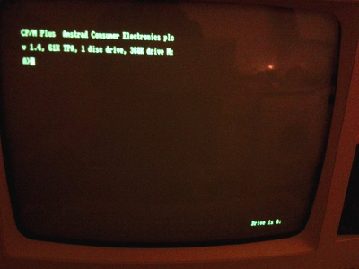

The booted PCW, showing a CP/M prompt.
2012-10-31 01.53.59-400x300.png (145.76 KiB) Viewed 6731 times
Ugh.. my horrible DB25F add-on (connected to internal disk cable).
2012-10-31 01.50.06-400x300.png (151.42 KiB) Viewed 6731 times
The HxC USB emulator and floppy cable adaptor.
2012-10-31 01.49.37-400x300.png (205.44 KiB) Viewed 6731 times
