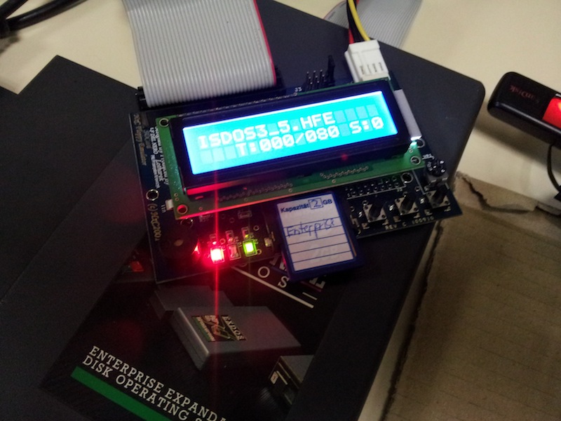

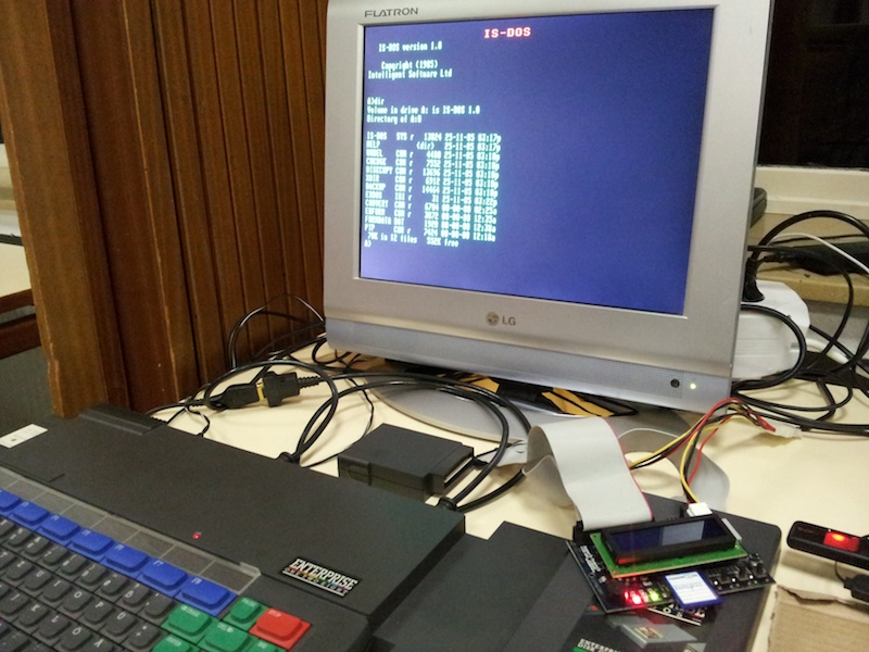

last week i tried to connect the SD-version of the HxC floppy emulator with an Enterprise 128-computer:
http://en.wikipedia.org/wiki/Enterprise_(computer)
I used an EXDOS-interface with it. That's the standard interface with built-in disk controller to connect Shugart-compatible floppy drives.
I set the HxC as drive A:, built some images with the HxC-software and used the 3,5" 720KB IBM-format.
And well, it works perfect (see attached photos) :)
So you can add the Enterprise as an official supported computer (when the Enterprise is equipped with an EXDOS-interface)
