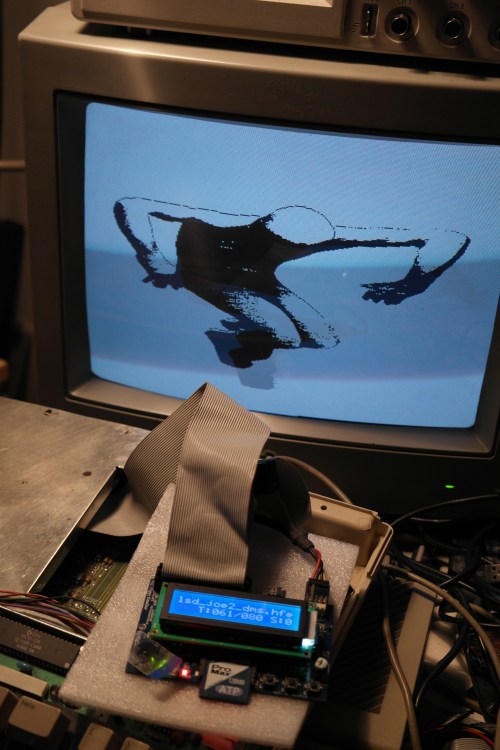

I have just retry it just in case of :
Run very nicely !
Some tips :
This demo WANT to use DF0 & DF1 in the same time ! Place the first disk into DF0 and the other one into DF1.
Use the Rev 2 HFE format.
Just in case of i sent to you the very last firmware used by email.

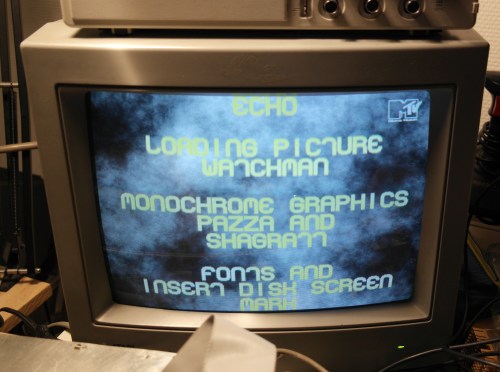

Re: Jesus on E's demo
Full demo watched :
:wink:

I updated the firmware and played the demo to the end :D
I am very happy, thank you for your assistance with this!
