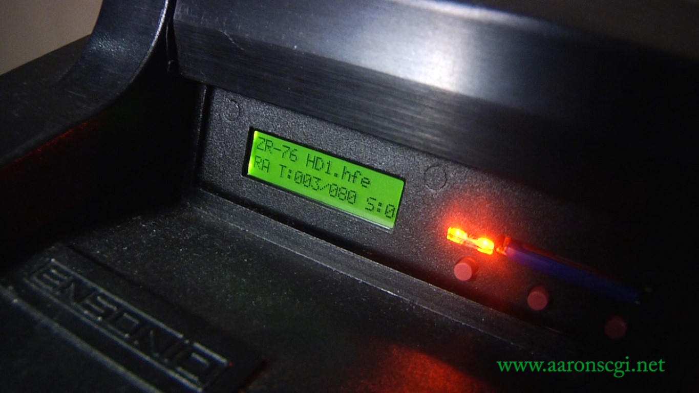

I am pleased to report that I have been successful in getting the Ensoniq ZR-76 disk image file to work after reading an earlier post regarding a 'Disk has been changed' error that the user was getting in his Ensoniq TS-10 - which plagued me in both my TS and ZR. As suggested in the post I changed the SD card's auto setting to IBM 1.44mb instead for the HD disk and resaved the CFG file. But that wasn't enough as I was getting disk write errors. I then resaved the earlier HFE files back into the HxC software again with the new SD setting and all is well. Not sure why the SD card settings would effect the image though? I was also more successful with ZR disks that had some sequencer data on it rather than a pure blank disk - not sure why. I was then able to reformat the virtual disk inside the ZR so it's clean. Strangely reverting back to the former CFG file that Jeff supplied, the ZR still works. Also when I load in Jeff's CFG file into HxC both his and my interface modes are set to auto? Anyway I can make the file available to anyone who needs it.

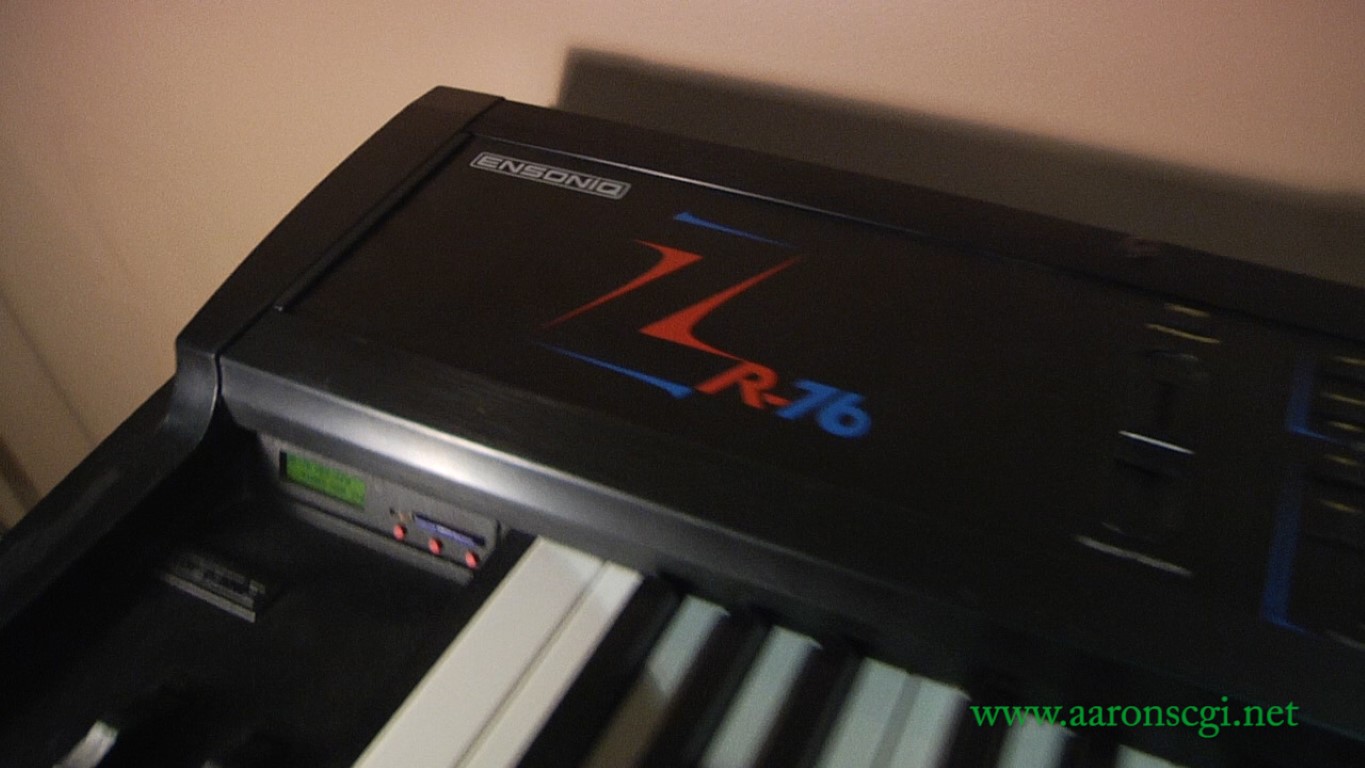

I have uploaded a Youtube video, some pics, and the Ensoniq ZR-76 disk image I made to your email address for placing in the showroom section.
Note that I tested your disk image in folder 'SDHxCFE_PC_1.44MB' of the collection and it works fine as well. Now users know the HxC definitely works with the ZR. Thanks for your assistance.

- ensoniq ZR76 with HxC SD3 (Medium).jpg (161 KiB) Viewed 8294 times
- ensoniq ZR76 with HxC SD1 (Medium).jpg (160.38 KiB) Viewed 8294 times
