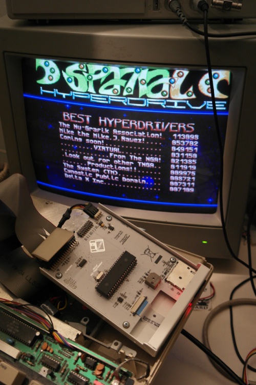

Tried here in normal HFE without any single problem.
Since you give me no details about your setup here are mines :
Amiga : Amiga 500 (Rev 6A motherboard) with 1MB of chip RAM (512KB in trapdoor).
HxC Firmware : 1.8.6.14a (https://hxc2001.com/download/floppy_driv ... rmware.zip)
Setting : HxC as DF0.
(PC twisted floppy ribbon -> Switch set to ID3A (4) (see picture). With a straight floppy ribbon should be set to ID0A (1) )
You don't give me any details about the used image so i have tried this one :
"Spatial Hyperdrive (1993)(TNGA).zip"
http://www.planetemu.net/rom/commodore- ... -1993-tnga
NOTE 1: Some games need to be on DF0 to work.
NOTE 2: Some games need to have all the other drive disabled to have the maximum free memory possible.
NOTE 3: Becareful with these old Amiga viruses : There are a lot of them on these ADF files, and one may have contaminated the HxC autoboot.hfe image and the other HFE file on the SD. To be sure redownload a fresh one to your SD : https://hxc2001.com/download/floppy_driv ... anager.zip.
Viruses may generate such strange behaviors/crash.
Just disable DF1: in setup and it works perfectly.

ok ok
Never had entered the F3 from the autoboot, I have to thank you for your great help, because it was actually putting that DF1 Off, the Spatial Hyperdrive works perfect, has now play thanks again to both. regards :D :D :D
