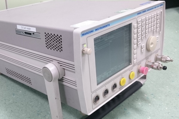

Marconi microwave test set 6200B
Post by atbukc »
I have installed a slim SD HxC floppy emulator in the above unit but cant get it to read or write any data, I have set switch IDOA on and have tried various different interface modes, but just cannot get it to work.
The Instrument is talking to the HxC fine as the HxC LED blinks when it is being accessed by the instrument, but it always states "Disk not present"
Any help to get it working would be gratefully received.
The floppy drive that I am trying to replace is a TEAC RD-05HF & it is used to save test result from the instrument that can then be read on a standard windows PC.
Thanks Andy

Thanks to Jeff the SD card slim emulator is now working well in this instrument.
Andy
