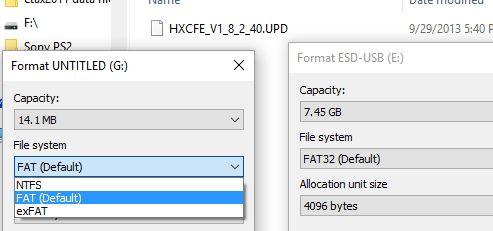

Re: SD card, Rev. C board, can't update firmware
Ahhh, okay I can see what was happening.
When I tried to format the 16MB SD card it only gives NTFS, FAT, exFAT as options.
When I check a USB drive, it gives FAT32 as an option.
Why can't I format an SD card as FAT32 then?
(Rhetorical question, I'm going to start searching the web for an answer).
Success!
Okay, so the problem was that my SD card wasn't big enough.
I had tried a 16MB and a 256MB but these only are offered FAT format in Windows. I had assumed this was FAT32.
I then tried a 16GB card and was offered FAT32 format.
But makes sense - why would you need to use FAT32 on smaller-sized drives? I guess there might've been someway under DOS to force FAT32 ... anyway, doesn't matter.
Thanks again Jeff.
Thanks again Jeff.
