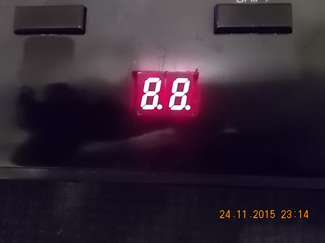

Hi
I Gotek sfrm72-TU100K with a two-digit display.
With the latest firmware v3.0.6.6a working.
Works only in version v3.0.2.5a, button down goes very quickly.
The fix is in firmware v3.0.6.0 shows the dysplay 8.8
well thank you
Here's display firmware v3.0.6.0.a and v3.0.6.6a

latest firmware 3.0.6.6 does not work properly

Hi
Gotek USB emulator HXC, does not show the "HC" V3_0_3_0a firmware and above.
It's emulator with 2 digit display.
Higher attached photo
Re: gotek two-digit display
miro wrote:Hi
ok... i will remove this autodetection and provide differents firmwares for each display type :(
