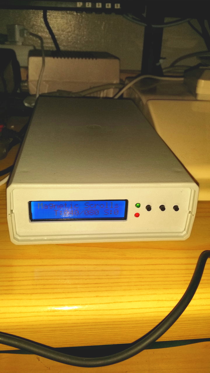

I used parts from an external Amiga drive and used the
modification to change the id of the external drive to df0.
Then i searched a long time for a box to install the gotek
and a lcd display into. Altering the case of my beloved Amiga wasn't a choice for me.
The result is pleasant for me. It works flawlessly. I'm a bad photographer. It looks better in real.
Btw.. If someone wonders about the missing usb connector.. I decided to put it on the backside, because for me an usb stick looks to pc-ish.

That is nice!!
Ron

I'm glad you like it Ron
