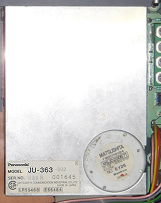

Did you search on the drive name and number? Here is all data needed to get it working in the right hands:
(I think the add-drive formats to 820 kb. The drives name is Panasonic Ju-363)
