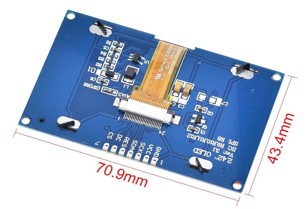

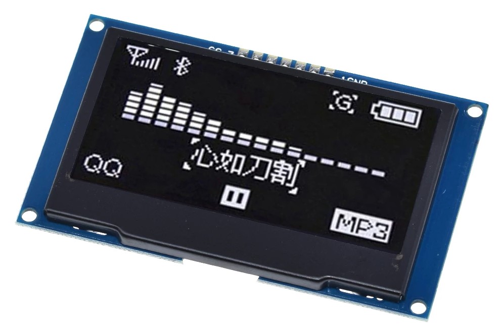

Ok,also compatible with this OLED 128x64 I2C SPD0301
Re: LCD 2004 Support and Rotary Encoder
danko wrote: Thu Oct 08, 2020 12:35 pm Ok,also compatible with this OLED 128x64 I2C SPD0301
Yes 128x64 screens are supported. You can change/select the screen model on this page : https://hxc2001.com/custom_fw/
