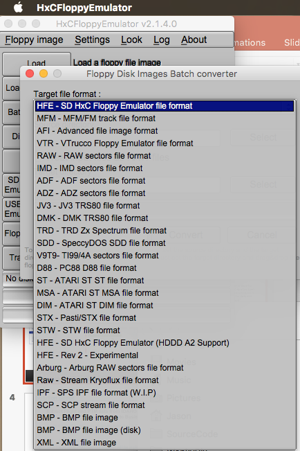

I am currently in the process of transferring around 60 Amstrad Disks to Memory Stick using Piotr's Fantastic USB Floppy Emulator.
In order to achieve this, the files on memory stick have to be a HFE file (no Problem). And I can transfer 8 disks (two sides) in one sitting.
However that leaves 16 files to convert from HFE to DSK, the Batch Converter of the software doesn't offer me an option of Batch conversion to Amstrad DSK and therefore I have to Load each file and Export, which is becoming time consuming.
What's the possibility of the HXC Software being updated to permit Batch Conversion from HFE to Amstrad DSK formats please?
Kind Regards
Jason
Screen shot of the Batch Conversion Options Available.
Screen Shot 2016-03-30 at 17.09.43.png (159.34 KiB) Viewed 55446 times

Jeff,
You are simply amazing! Thank you, I can confirm this has worked very well on 36 HFE files transferred so far.
Thank you so much :D
