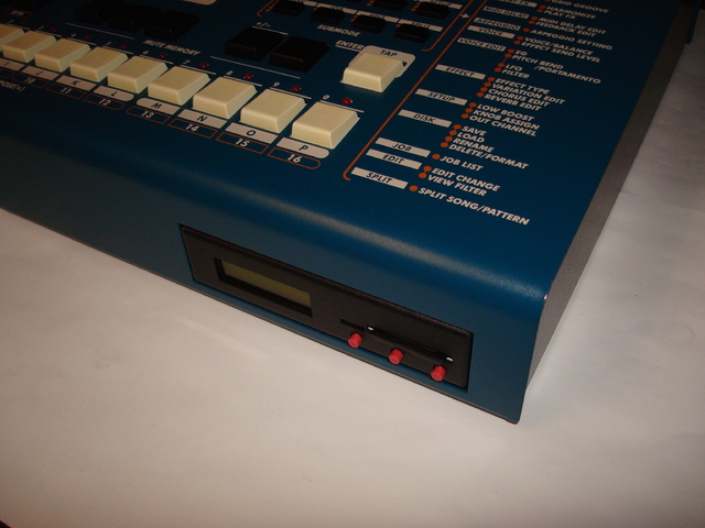

I thought I would share my quick and easy successful install.

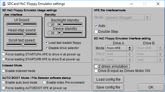

*Jumper Setting - ID1A
*HxC Config - Default (Optionally, I turned off 2 Drives Emulation and Disabled Drive Selector)
*Floppy IMG - SDHxCFE_PC_1.44MB

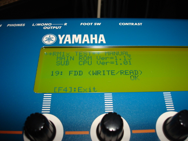

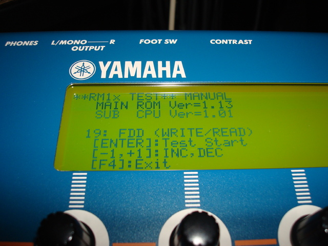

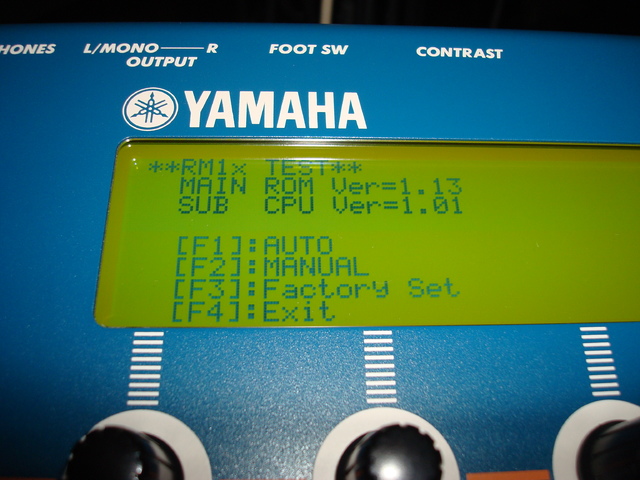

You can test the drive install using the RM1x Test Page.
*Power the RM1x on while simultaneously holding "Pattern", "Pattern Chain" and "Utility".
*Press/Select "[F2] : MANUAL"
*Press/Select "19 : FDD (WRITE/READ)"

RM1x Test Page.
