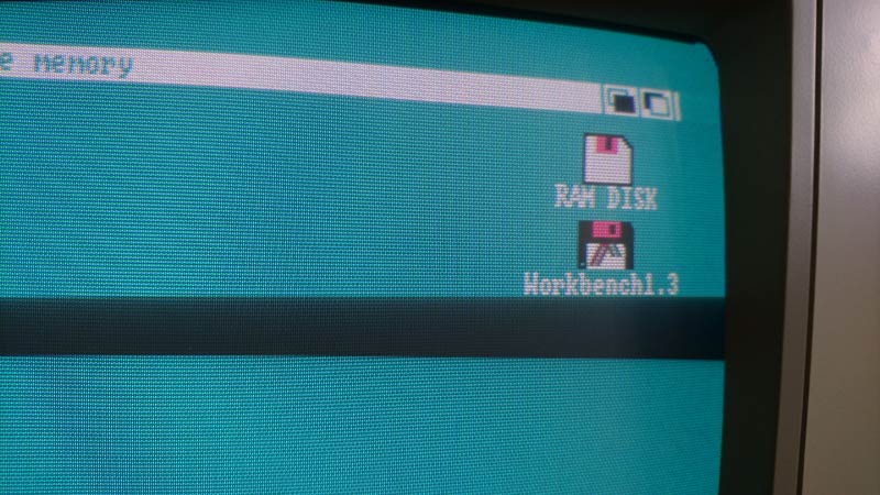

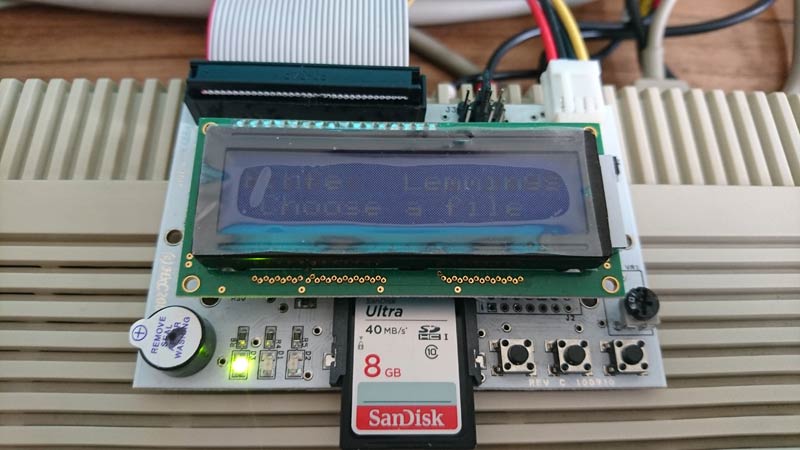

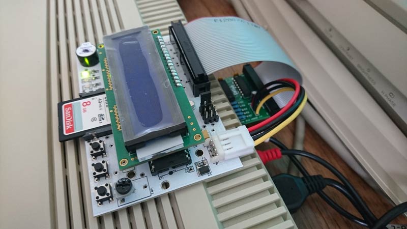

hello guys,
I bought a HXC SD floppy emulator some time ago for my CPC.
Now I want to use it for my Amiga 500.
So I also bought this adapter to connect my HxC to the disk port: http://amigastore.eu/en/440-amiga-exter ... er-m1.html
I set the jumpers to the DF1 position but when I start Workbench from internal DF0, no external drive appears. I'm using Workbench1.3 because I have no other version on disks to boot from.
I'dont know what I'm doing wrong, so I would appreciate any advice.
(When I disconnect the internal drive the HxC works as DF0 on the disk port with adapter.)
Does the SD card needs some special files to be recognised as DF1 or does Workbench also finds the drive with a missing SD card?

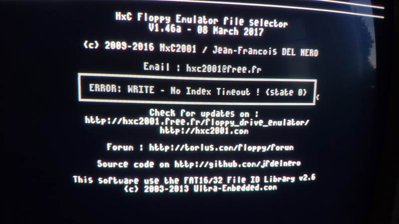

hello again,
I tried to solve my problem by using this boot selector:
http://www.ebay.de/itm/New-Boot-Selecto ... Sw4DJYig7q
Unfortunately it doesnt change anything, I have still the same problems as described above. Somehow the sd hxc is not really recognized as DF0.
If I want to autoboot from the external port set as DF0 the file selector displays the following message:
ERROR: Write - No Index Timeout ! (state 0)
What can I do to solve the problem?

Re: SD HxC not found in Workbench as DF1
The problem is for sure the adapter you are using. Can you post its schematic here ?

thx so much for your help Jeff!!
I changed the jumper to ID0 position and the HxC is now recognised as DF1.
I even managed to copy files from the HxC to real disks. Most games are running now without any problems.
