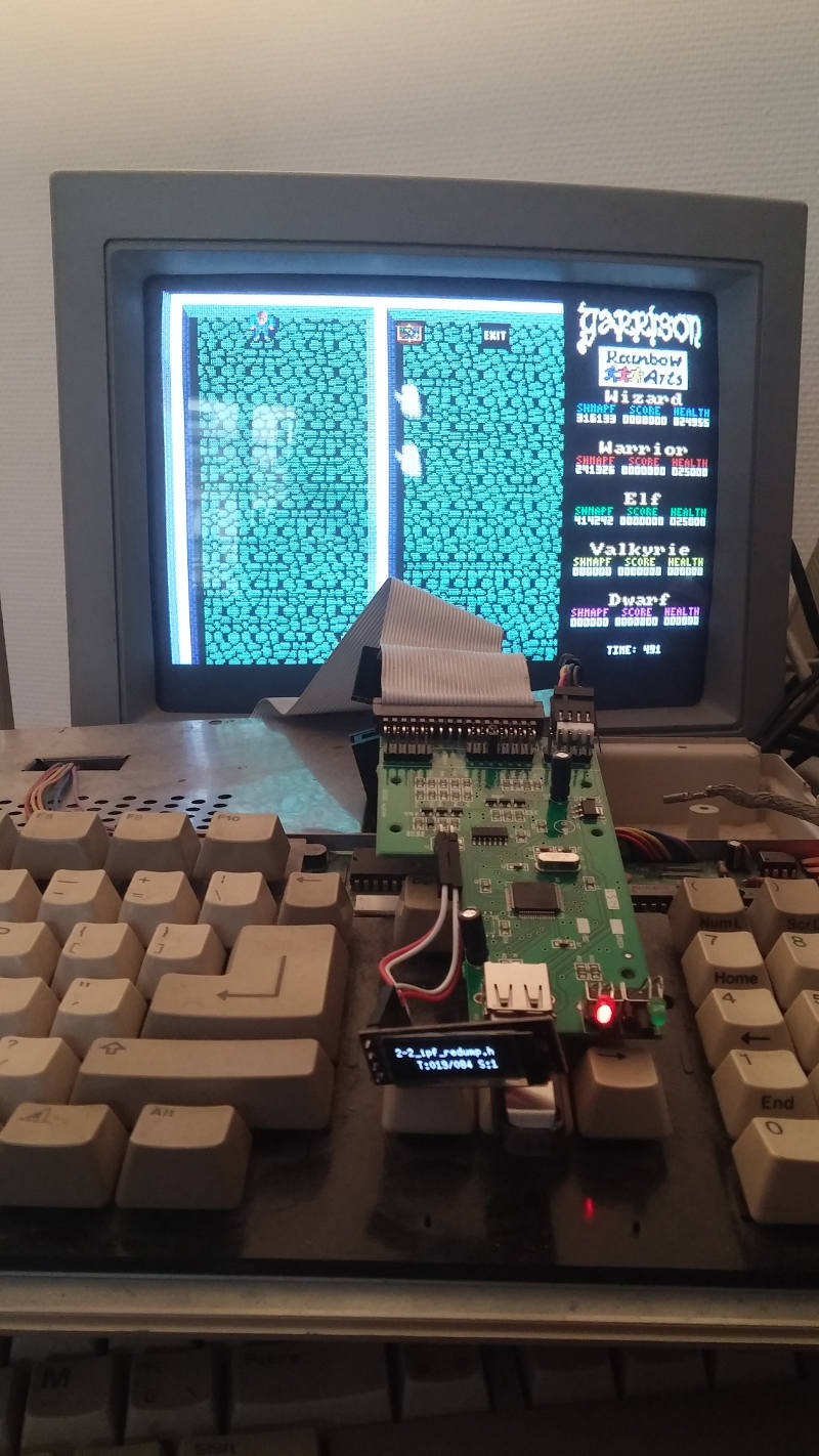

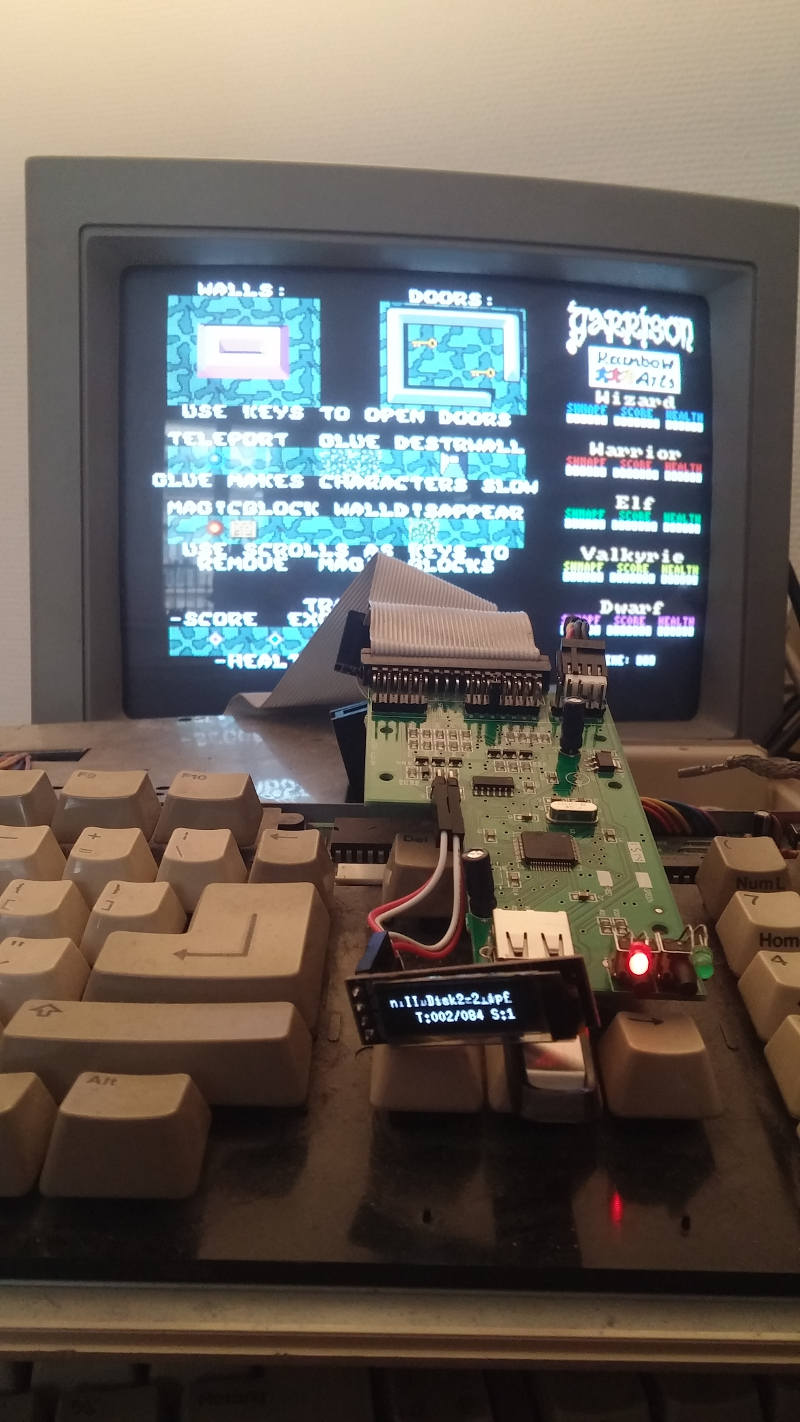

Re: HxCFloppyEmulator v2.1.8.0 Test 1 fail Garrison Disk 2 IPF to HFE rev3
Finally got this game working ! :
What i have done :
-> Regenerate a true floppy disk from the disk 2 IPF
-> Test it on the Amiga
-> Redump it and import it/convert again to HFEv3 directly from the KF streams.
-> Firmware : One sensible parameter have been tweaked into the firmware. This improve a lot some latencies but this can also generate other issues on systems with HD support, so i don't put it into the mainstream archive yet. a lot of tests must be done before this...
Here is the archive :
https://hxc2001.com/vrac/Garrison_II_HxCGotek.zip
use these hfe and update the firmware with the one present into this archive.
Please use the HFEs and the firmware present into this archive :
This work perfectly here with an Amiga 500 with 512KB of RAM.
BTW This game with 1MB of RAM on the very same the Amiga doesn't seem to work (same problem with floppies or the emulator). I will check again this.
Have you the floppy disks of this game ? Maybe you have another version ? Can you dump them ? Have you a kryoflux board ?
I confirm that this game doesn't seems to work with more than 512KB (loading stop at track 21 on the first disk)
With 512KB it works perfectly :
