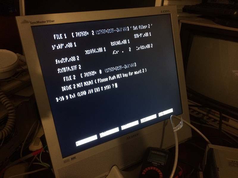

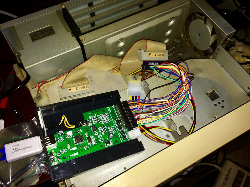

I ended up building an adapter board, though the first run has a lot of mistakes that I would like to fix before I give out the kicad files and BOM. Unfortunately I am quite new to electronics.
I used the HxC firmware on a Gotek. Great stuff! :D
I can confirm that Nishida-san's adapter schematic above works.

Update: this adapter had some problems when I was trying to use two drives at once. I made a new version that was just a Shugart straight-through (e.g. pin 2 to pin 2, 34 to 34, etc) that adapted the edge-connector to a 34-pin female IDC floppy connector.
Now it works great with two Goteks. Thanks for the firmware and the hint, Jeff!
