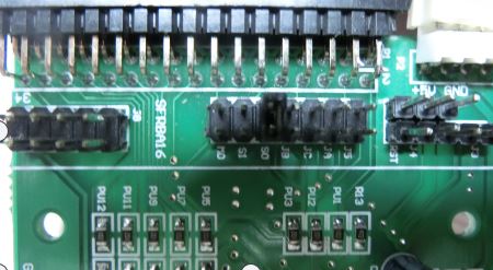

On inspecting the board, it is not quite the same as the 3 digit version I also have. There is an extra header near pin 34 of the ribbon connector, which has pins corresponding to the I2C header and pushbutton switches, presumably to facilitate connection to a remote User Interface.
However, I proceeded to flash this unit successfully, and add an OLED display. All is working with the 2 built in pushbuttons in my Yamaha EL90 organ after setting Custom Interface (pin2 = nDensity, pin 34 = nReady, for anyone else with ELx0 instrument . . . . . ELx00 uses PC Interface)
