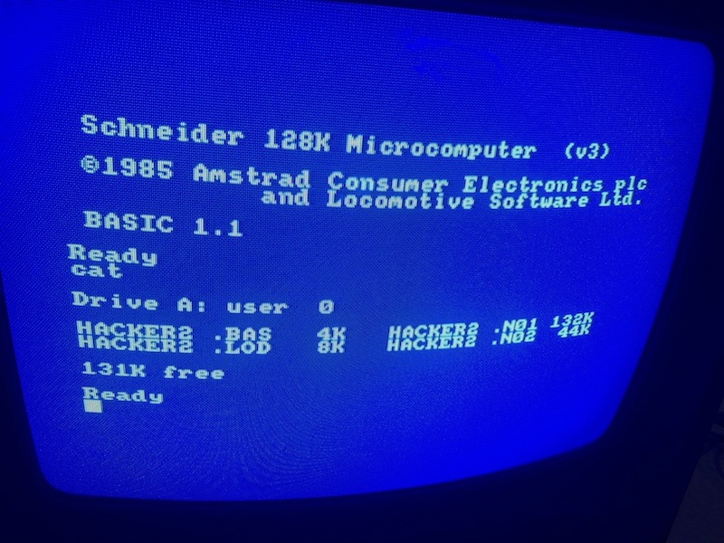

But when I convert a dsk image to a hfe and try to use it, the file sizes which are displayed when issuing "cat" on the Amstrad are totally wrong. When I try to run them (run "myprog"), they to not start - the Amstrad loads the file, but just says "Ready" instead of starting the program.

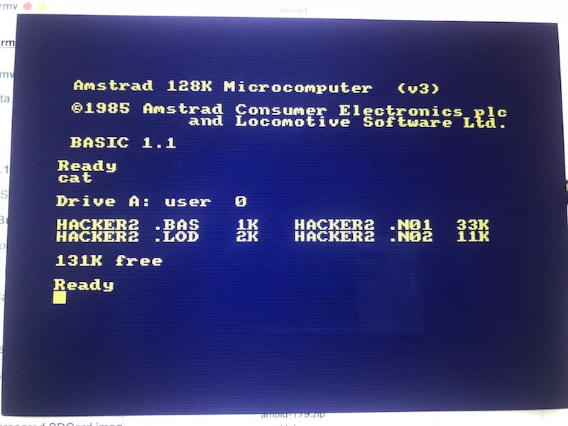

When I load the source dsk image (which I later convert to hfe) in an emulator, the disk sizes are correct.

source sdk in emulator.jpg = loading the source dsk in an emulator - "cat" displays the correct file sizes / dsk runs correctly:
source dsk in emulator.jpg (116.88 KiB) Viewed 58350 times
hfe in amstrad.jpg = I converted the source dsk to hfe and put it in the HxC. The "cat" command displays wrong file sizes / files cannot be run:
hfe in amstrad.jpg (174.25 KiB) Viewed 58350 times

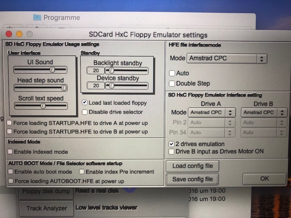

config.jpg = configuration of HxC. Same problem ocours with the default config:
Firmware is up to date - HxC Software is up to date, too. I use the Mac version.

It seems that there an issue with some cpc dsk and the new hxc software.
with older version this appears to work fine :
https://sourceforge.net/projects/hxcflo ... p/download
i will fix the issue in the next release.
