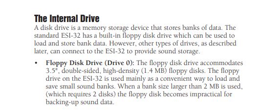

I just uploaded an example: [which i´m able to load on my Emu ESI-4000] and attached screenshot from the ESI-32 manual.
https://www.dropbox.com/s/59y8oemoq35xh ... i.zip?dl=0
ok so the answer is "no".
Please use another usb stick to format the hfe or try to format the img file.
