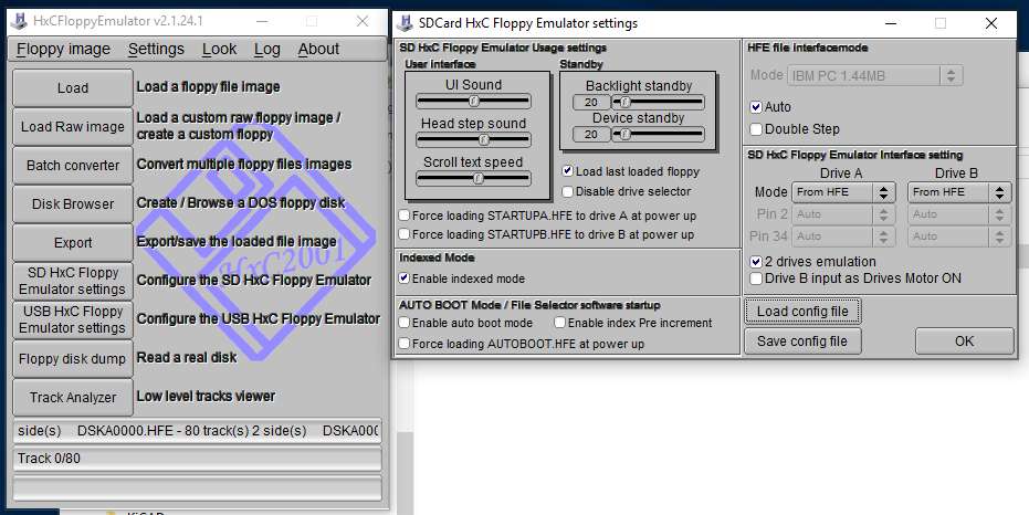

My setup is attached, it would help if you can verify that this setup looks OK.
The HFE is from the DOS144 downloadable images.
Thanks again for any more suggestions.
- HP54624A.jpg (89.52 KiB) Viewed 66447 times
Re: HP 54624A Oscilloscope & TEAC FD-05HF - Failed Startup
Please instead use the indexed system : name the file DSKA0000.HFE and disable the startupa.hfe feature.HxC-Harry wrote: Mon Jul 22, 2019 12:37 pm Jeff, thanks for the fast reply!
I have installed 3 pullups, but same problem. "Failed Startup Initialization"![]()
Before I start probing on pins with the logic analyzer, do you have any other ideas, or does anyone else have a working setup I can copy.

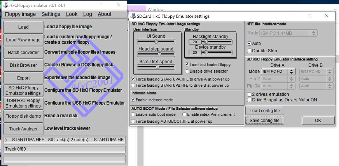

Sad to say, still not working. I tried to reflash the firmware - 2.1.2.40 and 2.1.6.14a - both same error.
Using 2.1.2.40 and the HFE images from Slim_SDHXCFE_DOSHD.zip, copied as DSKA0000.HFE and DSKB0000.HFE.
CFG as shown below
-> "Failed Startup Initialization"
I'm starting to think maybe hardware fault? Any other suggestions?? Do you think it it would be useful to put the logic analyzer on the ZIF bus and watch the startup process?? (Or maybe just order another board, if it looks most likely to be hardware)
Very grateful for your thoughts
CFG as shown below
- HP54624A-2.jpg (64.73 KiB) Viewed 66432 times
