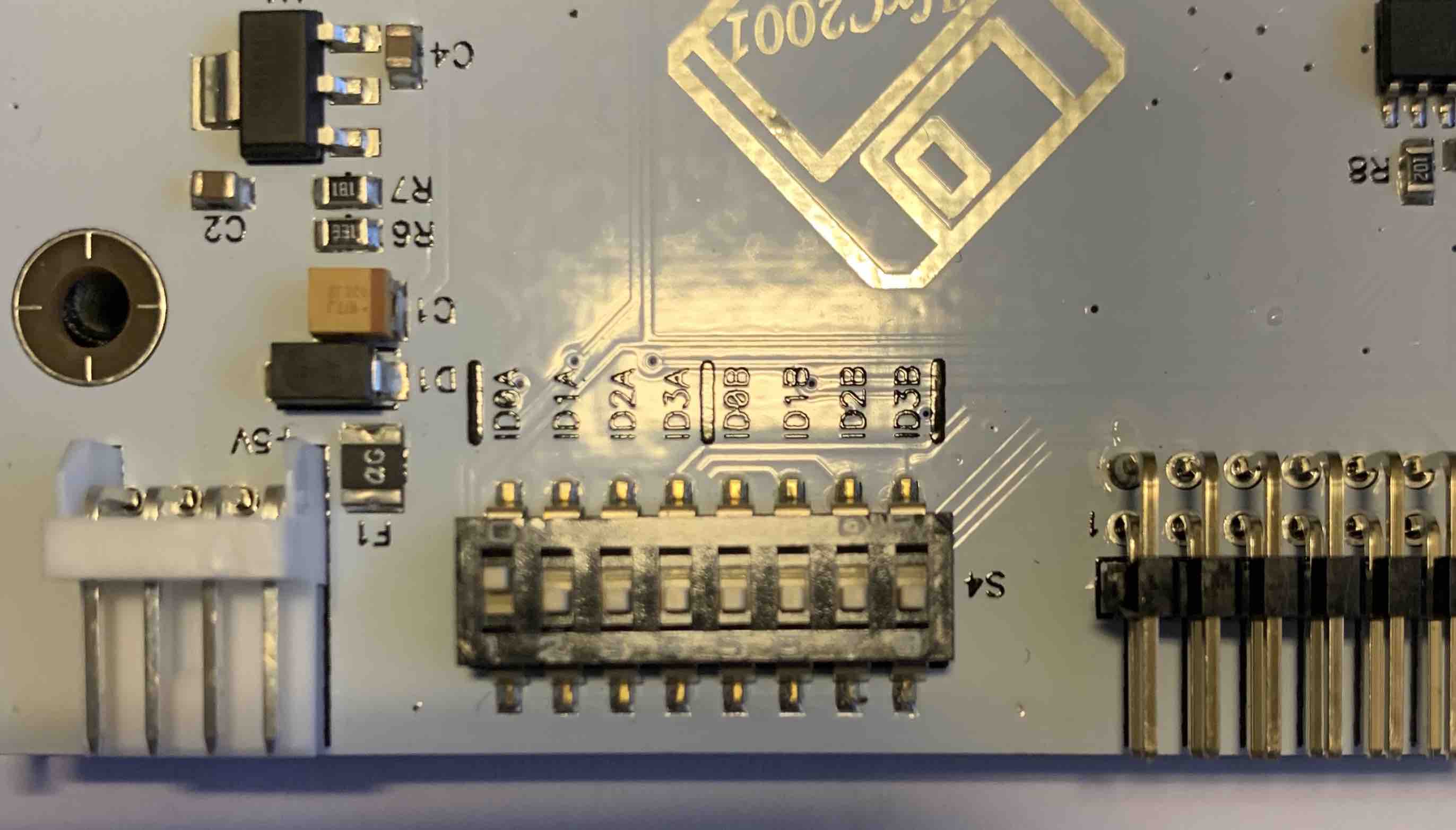

I'm ready to install a new HxC in my SP1200.
In videos found online I see where to add jumpers, but on my Hxc model the pins where jumpers had to be added are replaced by a switch.
(see attached picture)
So what are the correct settings for SP1200 on that little switch?
By default ID0A is up, while ID1A, ID2A, ID3A, ID0B, ID1B, ID2B and ID3B are down.

ID0A up is fine for the SP1200.
