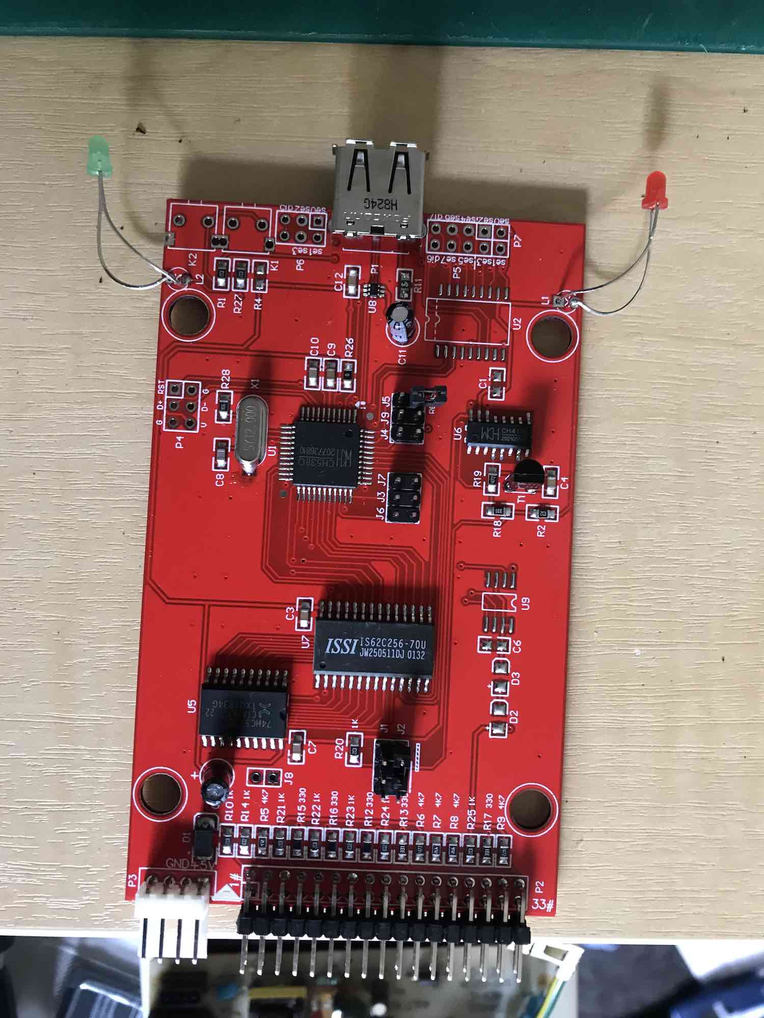

I think you can't install the HxC firmware on this unit. This doesn't seems to be a Gotek clone. But Please take a picture of the pcb and share it here. Then we will be sure.gkmaia wrote: Fri Jan 03, 2020 8:51 pm I am struggling to get it right. Did read several posts and still confused. I have just one question. Sorry if it is dumb...

Here u go. I thought it was a GOTEK clone.
http://www.eilasung.com/en/ProductShow.asp?ID=24

Re: Format a USB stick as EPS 800kb to then use on a FDD-UDD-STD144
Definitely not a gotek i am afraid...

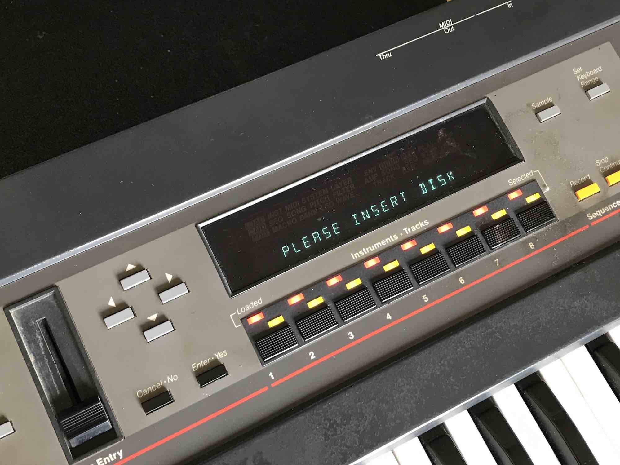

I finally got the new drive.
Did run the following update
Please see video attached: https://www.youtube.com/watch?v=TnNGcwr-jeE
When connecting the drive to the EPS I get the insert disk message so I believe the EPS understood there is a drive.
When connecting a pen drive to the drive nothing happens. No LED lights up on the drive neither the EPS tries to read the drive.

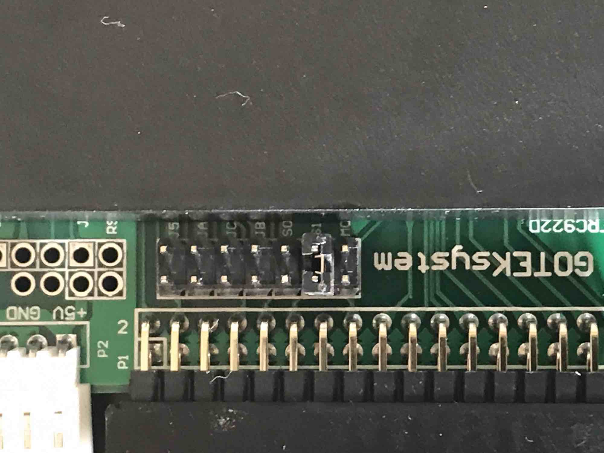

Also a photo with my jumper setting.
Some progress... following this thread
https://hxc2001.com/floppy/forum/viewtopic.php?t=3250
Se the jumper to S0 and renamed all files on https://hxc2001.com/download/floppy_driv ... Images.zip and put into the disk.
Also used the CFG file that was inside https://hxc2001.com/download/floppy_driv ... rmware.zip
Now the drive flashes and seems to read the USB stick. As I change between disk images it also attempts to read.

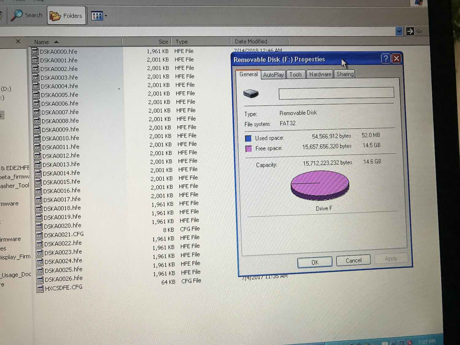

But asper video https://www.youtube.com/watch?v=qmailVy4ebc after trying to read I initially get the "disk not formatted" message, then keeps asking to "insert disk".
Attached is an image of the contents and format of the usb stick.
This Gotek is not flashed with the HxC firmware.
You need first to install the HxC firmware (https://hxc2001.com/store/).
A gotek with the factory firmware doesn't work with the Ensoniq EPS.

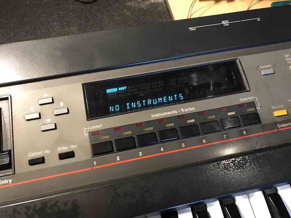

So finally got it to work and it did the firmware update. Weird as it toke ages to sync... but it did in the end.
Can you explain why this file needs to be in the usb pen drive root all times and what it actually does?
HXCSDFE.CFG
HXCSDFE.CFG

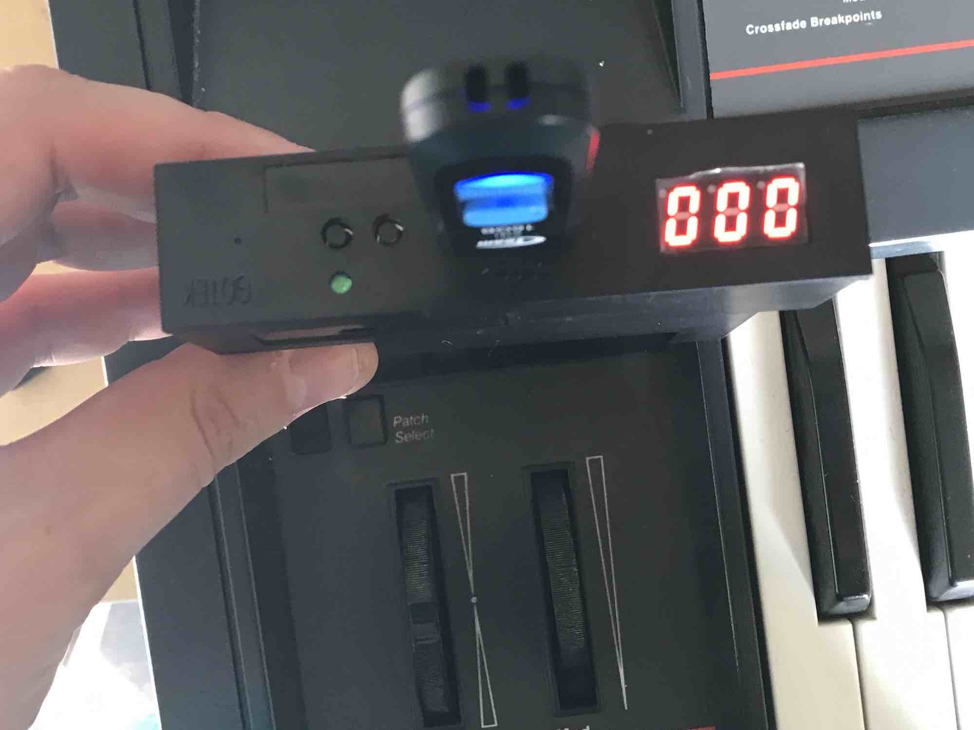

It worked!!!!
- IMG_7594.jpg (48.61 KiB) Viewed 69823 times
